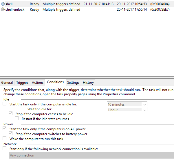

    2017-11-20T20:21:52+00:00
    this update makes my pc wake from hibernate too;
    it messes with the wake timers regardless of any powercfg settings.
    A solution;  uncheck  "Wake the computer to ruin this task" in the Task Scheduler under the "rempl" folder:

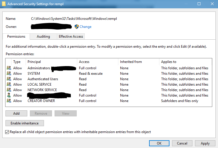

    then in "C:\Windows\System32\Tasks\Microsoft\Windows\rempl" adjust the security settings for SYSTEM like so:
    Make sure SYSTEM can only read and execute that rempl folder and it's files,
    so it won't write changes to the file to wake your pc from hibernation all over again -.-

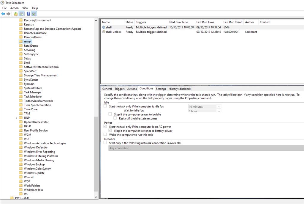

    2017-10-09T05:39:26+00:00
    windows 10
    1511 (10586.1106)
    This is the task:
    This is the task code, exported in xml:
