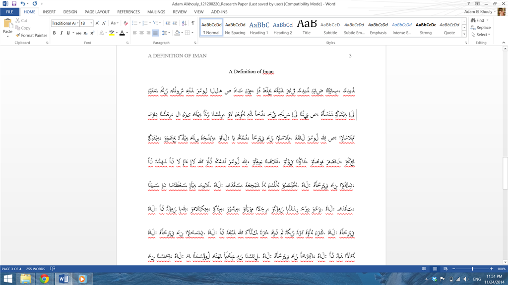

    2014-11-24T20:03:38+00:00
    I am having the exact same problem. Please advise!
