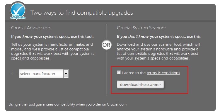

    Hello, I was hoping to find out how much ram in total my PC could hold.   I know for sure that my PC came with two memory slots with 4 GB in each for 8 GB's total.  I already replaced each 4GB chip with an 8 GB chip.  Therefore I have been running 16GB for a while.  I was hoping that since this is a I7 inter quad core it might be able to handle 32GB or so.   Anyway, if you could explain how to find that out it would be great.
    Thanks a lot.
    I presume that you are running 64 bit Windows as your machine came with 8G of memory.
    For those running 32 bit Windows there is no point in installing more than 4G of memory as 32 bit Windows cannot use more.
