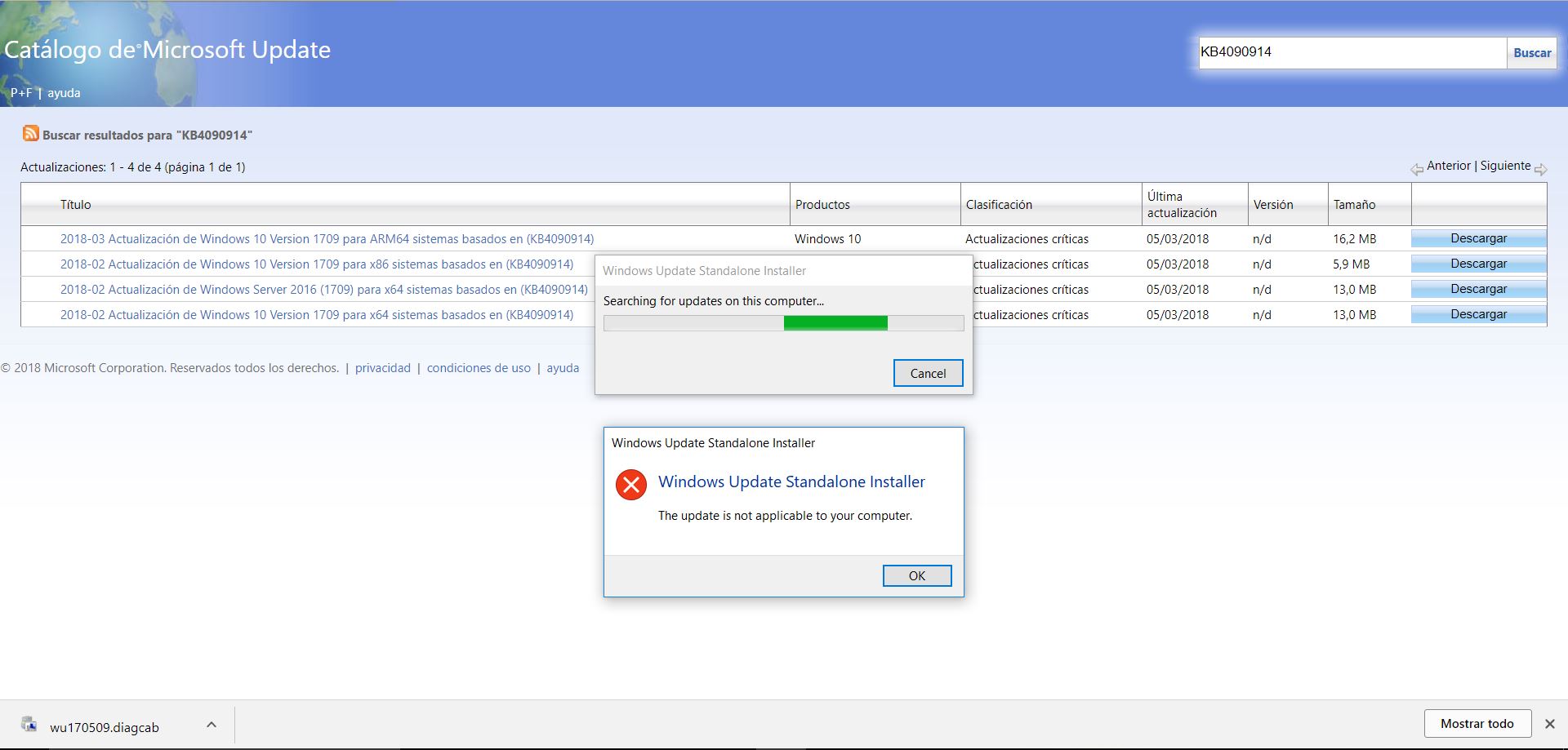

    Well, I tried everything you suggest, but nothing works, the error is still there. I only didn't try to "Perform a clean install of Windows 10" because I will lost everything and I think there should be the ultimate alternative.
    I tried to do separately updates instalations after my the last successful automatized instalation. The last one was KB4033631, so I tried to start from the acumulative last update available, but didn't work. It says:
    And everyone I tried, inclusive the next one after my KB4033631 was KB4034674 but had the same message error "The update is not applicable to your computer" (acumulative and diferential). So if any of them are applicable to my computer, why is it trying to install them? What could be wrong?
    Thanks for your help.
