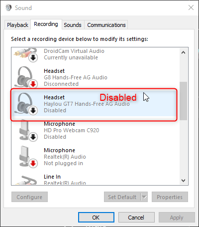

    If the Hands-free telephony option is reenabling after the restart, another option is to disable the hands-free device under Settings > System > Sound > More Sound Settings > Recording tab and under Playback tab.
    Test it and tell if it changes after the restart or reconnection. if it doesn't work we can try other fixes.
    Example:
    36 people found this answer helpful.
