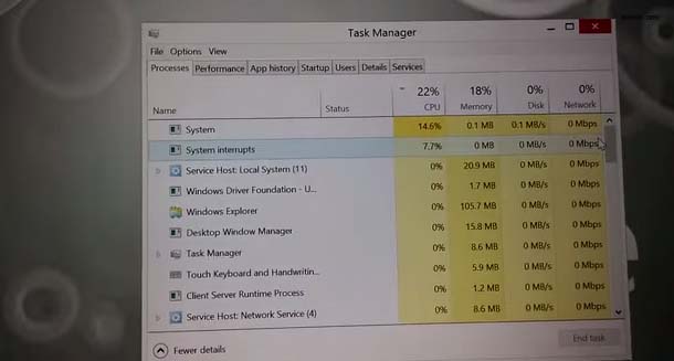

Has anyone else noticed that coming out of sleep or herniate results in unwarranted high cpu load from system interrupts?
I have all the latest firmware and updates loaded. But using sleep even sometimes a cold boot I get this issue.
How can I fix this please. Its killing my battery life.

    Oh!! I just checked it again as I wanted to make a screenshot and now it's working! I don't know what changed. The only thing I did was that I originally enabled Hyper-V but when it started interfering with my WiFi connectivity I disabled it again, so maybe that's what was necessary.. I used to have constant high "System Interrupts" process running, but disabling one by one I found out that an Adobe startup process was causing it, so I disabled it and it seems to have fixed the issue. Either way, thanks for your responses!
