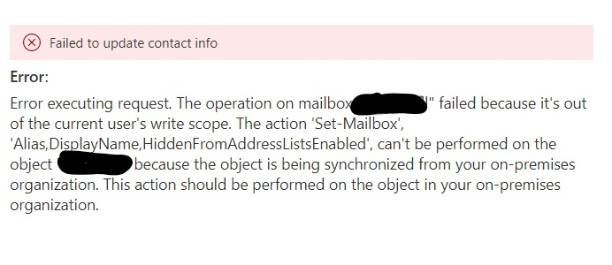

Hi, I've been working to remove former employees from my GAL and really have been struggling to find a solution that works. I have tried many different ways including: “msExchHideFromAddressLists” in AD, making sure the account has a mailNickname and email set in the attribute editor. I have tried using the PowerShell CMD "Set-ADUser 'user' -Replace @{msExchHideFromAddressLists=$true}" and it takes the command but it does not seem to sync. I have even tried to hide the user from the Exchange Admin Center and I get the attached error message. There are no errors in the DirSync section. I'm out of ideas. Thank you for your help.

First the error you provided above is expected when you tried to make changes to the users who were synced from local AD, as the changes need to be done from AD then sync to Microsoft 365 Azure AD/Exchange Online.

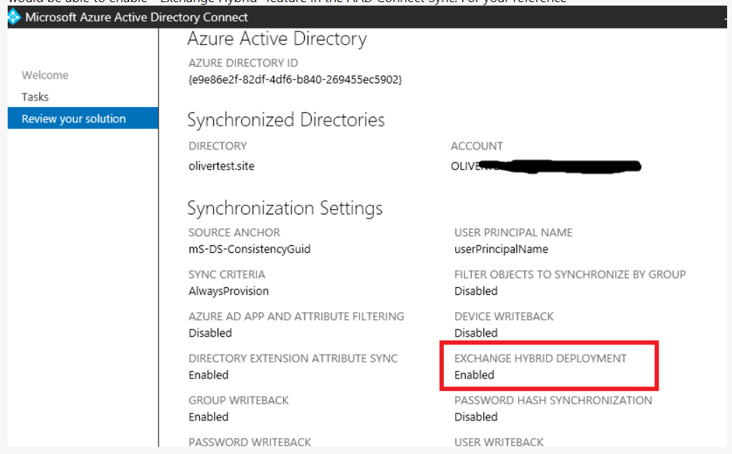

Also, as far as I know if you are using AAD Connect Sync, the attribute "msExchHiddenFromAddressList" was not synced by default, and we need to enable "Exchange Hybrid" in the AAD Connect Sync to make this attribute synced to Cloud side, please double check if you enabled "Exchange Hybrid" in your AAD Connect if you are using. if so, in this case please open the Synchronization Service Manager from your AAD Connect Sync server > Metaverse Search > Connectors > double check both connectors ( on-premises AD and Azure AD ) > check if you could find the attribute "mxExchHiddenFromAddressLists" with true there. For your reference

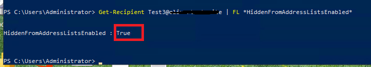

If you could find this attribute in both connectors from your server manager, in this time, please connect to Exchange Online PowerShell and run Get-Recipient ******@domain.com | FL *HiddenFromAddressListsEnabled* to see the result

    According to your description " It does not appear we have any agents downloaded in AAD Connect." may I double confirm if this means you didn't have AAD Connect Sync installed in your environment? Generally, if you have on-premises Exchange server (Exchange 2010 or above), and with the first time to install the Microsoft AAD Connect in your local AD ( DC), you would be able to enable " Exchange Hybrid" feature in the AAD Connect Sync. For your reference
    Please double check your current configurations on the AAD Connect Sync, and see if it was enabled or not, thanks.
