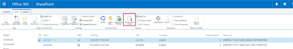

Once you’ve enabled the custom script, please follow the steps in this article under the section Online,2016,2013 to know how to Create a list template, Download a template and Upload a template to the list template gallery in SharePoint Online.

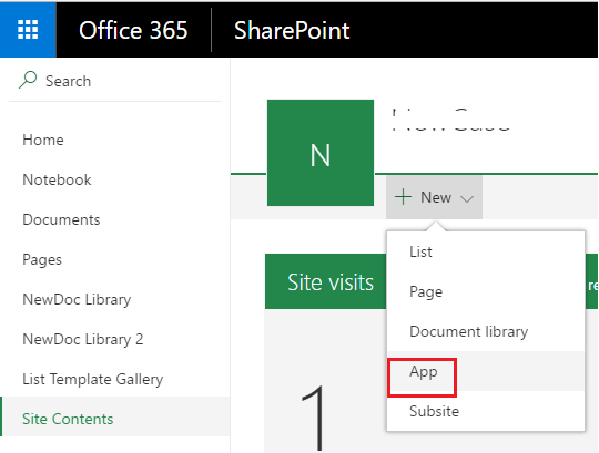

After following the last step from the article i.e**. Upload a template to the list template gallery in SharePoint Online,**go to the site, **** click Settings>Site Content> New>App.
In the search box, type the name of the list template which you saved and from the search result click on the list template. It’ll ask you to provide a new name. After giving the name, you can use this list.
Please note, if you are using the Office 365 group site, then this feature is currently not available.

    2017-06-06T16:10:24+00:00
    What does the statement below mean?
    "If you are using the site connected to group i.e. Office 365 group site, then these sites do not currently support list templates."
    I am a part of an Office 365 team site. Then I created my own site there.
    Does that mean list templates are not available?
    Looking at the screen shots you posted, I can never figure out how to get to those places.
