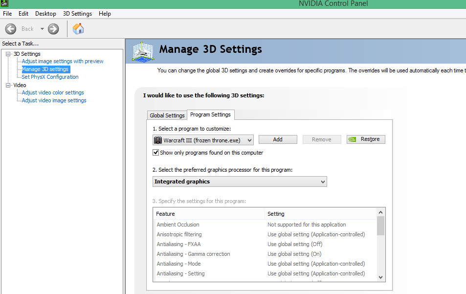

    2013-09-06T17:43:55+00:00
    I think you need to setting your video card .
    exam : I have intel card and NVDIA . When I select like this, it's work :
    100+ people found this answer helpful.
