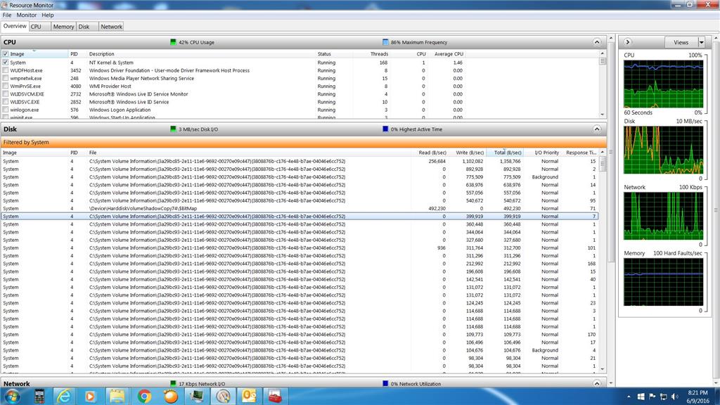

I have had a Windows 7  Core I7 system running at home for several years and performance has been fine. Lately, the system has started running very slowly and I can see the disk activity light stays full on for extended periods. I looked at the Performance Monitor to see what was bogging things down and it seems to be  PID 4, the System process, that is using all the disk resources.
I did some searching and found some similar posts in various places but most of those posts are several years ago and pretty generic, like check your disk for errors. I have a disk monitor that says my disk is perfect. I ran the troubleshoot which cleaned up a bunch of temp files. I removed a few startup programs. Nothing has really changed on my system in the last few days but it sure is acting different.
I tried rebooting and boot time seems to have become excessively long. If I leave the system alone for a a while the disk activity slows down but as soon as I web browsing, the activity goes way up and everything runs slowly. Again, this is new behavior within the last two weeks.

    well I sort of fixed the issue. On further digging in Resource Monitor I found the list of everything going on in pid 4. The big disk users were all using files starting System Volume Information. So I searched on that and found that is due to System Restore. Turning off SR fixed the problem. My disk is nice and quite now and am getting great system performance.
    But this bring up another question. Why did SR recently start overacting? I've had the system for several years and never changed the SR setting before. So why now did SR start causing problems?
    below is a screen shot showing the high disk usage.
