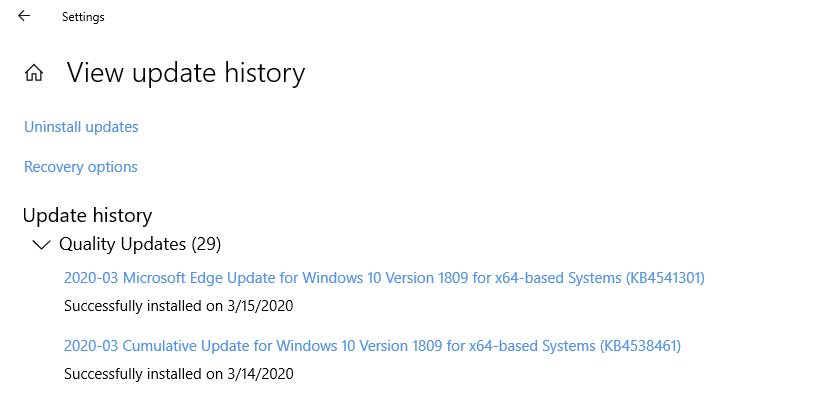

    But still I am sure that the battery is physically sound as laptop was operating on battery the day before yesterday. After I updated issues suddenly started to show up. The update was -
    Thanks for your help
