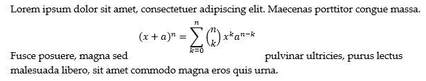

    I can see one way to do that, although not with the best of appearances. The key is to use a text box to "trick" Word into seeing the equation as being in a separate paragraph although it's in the middle of other text.
    • Insert (or draw) a text box.
    • Click the Layout Options button to the right of the text box and click the In Line with Text item. That will place the text box at the start of the paragraph; drag it to the location where you want the equation.
    • Right-click the edge of the text box and click Format Shape. In the format pane, set the Line to "No line".
    • Click inside the text box and create (or paste from elsewhere) the equation content control.
    The one thing I don't think you can fix is that the bottom of the text box will align with the baseline of the text around it, and the bottom of the equation will be slightly above that. This makes for a rather ugly setup:
