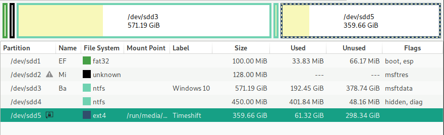

Windows 10 is on partition /dev/sdd3
I have an Ext4 partition on /dev/sdd5 for backups.
When I use Linux, shutdown and reboot Linux, the partition is mountable, but after using windows 10 and rebooting into Linux, the partition is  not mountable.
I have to use Gparted to fix the mess that Windows 10 made. Why is Windows 10 even accessing the sdd5 partition not to mention altering it?
The screenshot shows my disks in Gparted. After using Windows the USED and UNUSED columns return --- and ---
I don't know what /sdd2 is, but it looks like it has problems.

    Also the partition /dev/ssd2 is system reserved partition. You can see the details under Flag section, it says msftres (Microsoft reserved).
