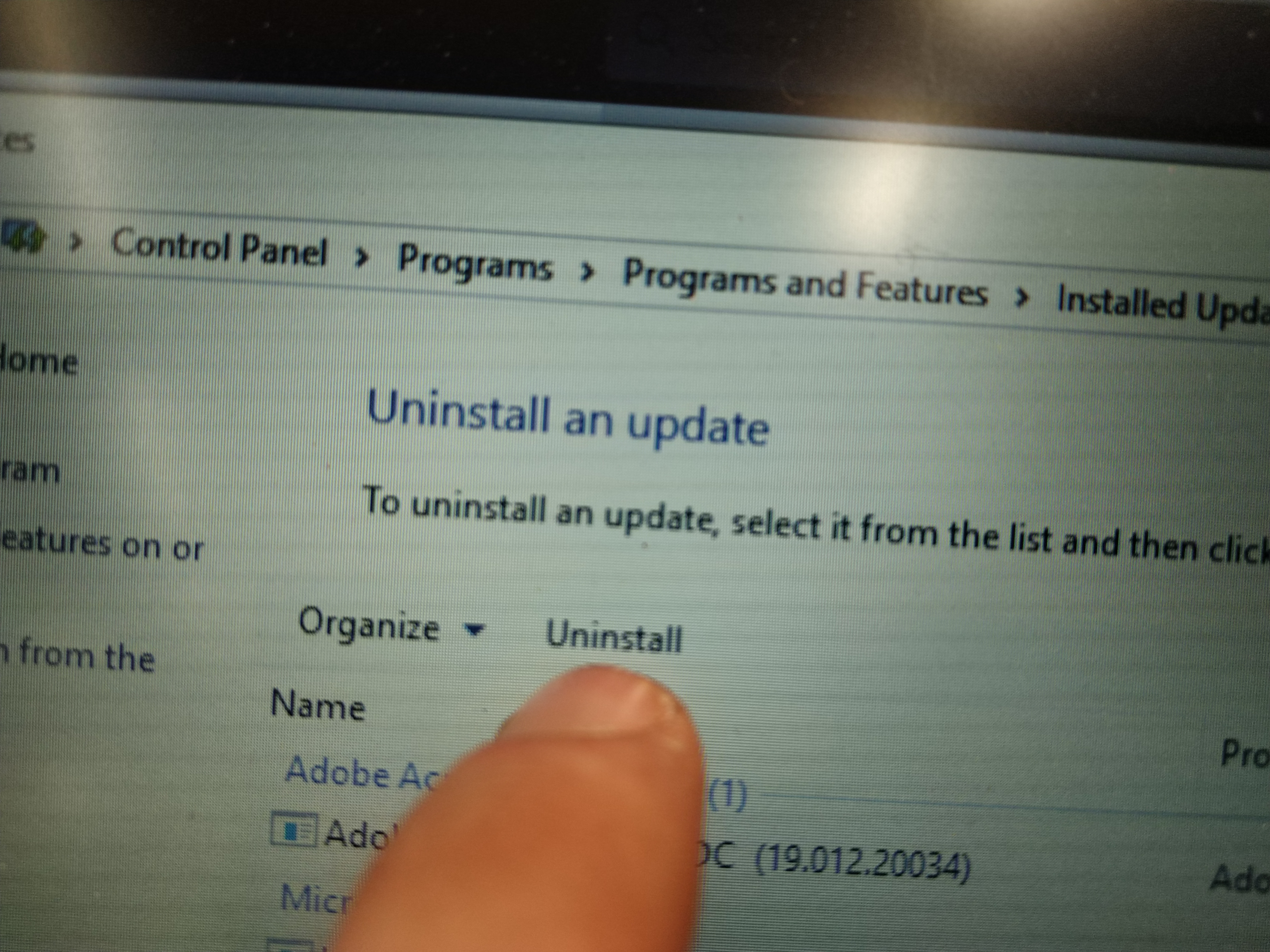

Hi, I've been having an issue with Windows Update KB4579311. When it gets installed it causes the Explorer to crash repeatedly until it eventually logs me in, at which point I can use it as normal. BUT, the crashing increases time it takes to log in and load everything up. It's very annoying.
What I mean by crash is that the start bar flickers on and off, over and over and over. The desktop is black the mouse curser is visible. when you press ctrl alt del that screen stops flickering, when you return back to the desktop, flicker ahoy! you can see in the task manager that the explorer is stopping and starting over and over. You cant manually end the process becuase it's starting and stopping so fast that by the time you click the end process button it's already restarted and the instance of the explorer you tried to end no longer exists.
Uninstalling KB4579311 stops the issue but when it installs it's self again the issue returns.
I'm getting tired of repeating the same steps over and over to use my computer as intended.
This is shown in the event viewer:
Faulting application name: explorer.exe, version: 10.0.19041.546, time stamp: 0x89ce2e55
Faulting module name: ucrtbase.dll, version: 10.0.19041.546, time stamp: 0x43cbc11d
Exception code: 0xc0000409
Fault offset: 0x000000000007287e
Faulting process ID: 0x21e8
Faulting application start time: 0x01d6a45d9c54ed23
Faulting application path: C:\Windows\explorer.exe
Faulting module path: C:\Windows\System32\ucrtbase.dll
Report ID: 0fa45953-9e3f-4a5f-bafc-ee4c5229c9ca
Faulting package full name:
Faulting package-relative application ID:
What I'm looking for is a fix. Not a workaround.

    Has there been a fix for this? My computer keeps automatically installing this update and in turn I have to keep manually removing it. But I think now it is permanently installed, and the explorer will simply crash for 5 minutes every time I turn on my computer
