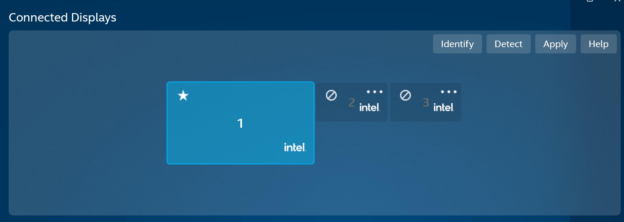

    2023-10-20T15:29:19+00:00
    Hi. I have the same problem and I tried that but it does not work:
    After clicking the 3 dots and the "Enable" option for the 2 monitors, they stayed the same (as picture)
    30+ people found this answer helpful.
