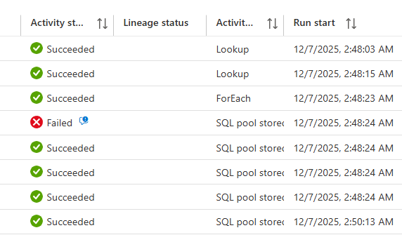

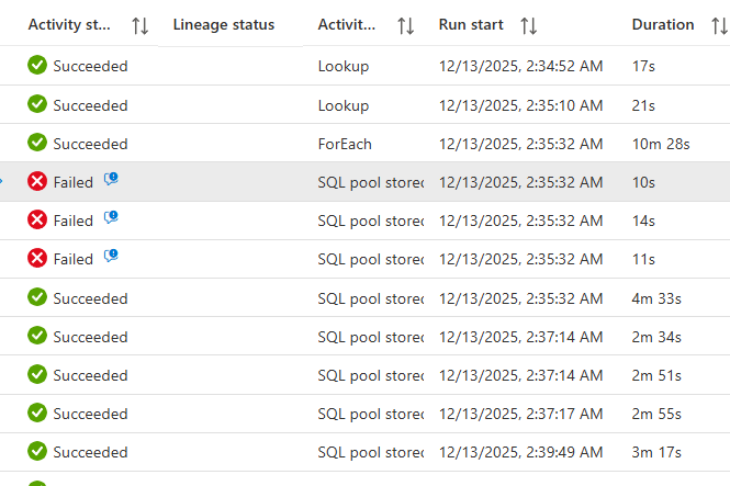

I have an Azure Synapse pipeline with an activity that runs daily at 2 AM. For the past 6 days, this activity has started failing with the following error:
{ "errorCode": "2402", "message": "Execution fail against sql server. Please contact SQL Server team if you need further support. Sql error number: 8642. Error Message: The query processor could not start the necessary thread resources for parallel query execution. Reduce load on the server or use the MAXDOP setting to limit parallelism.", "failureType": "UserError", "target": "Ejecutor SP", "details": [] }

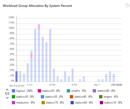

This error has never occurred before with this activity. The DWU (and CPU) utilization during the pipeline execution reaches close to 100%, but it has been at this level for months without any failures. There are no queue delays during this period, and other activity parameters have not changed.
I would like to understand why this pipeline suddenly cannot start the necessary threads to execute the query in parallel and what mitigation steps are recommended.

    The error indicates that the SQL engine was temporarily unable to allocate the worker threads required to start parallel execution. This happens when the system experiences resource exhaustion, commonly due to:
    High concurrency or heavy query load during that window.
    CPU, memory, or IO pressure within the SQL pool.
    Parallel execution plans requiring more thread resources than the engine could allocate at that time.
    Momentary resource contention or throttling on the underlying Synapse/Dedicated SQL Pool engine.
    Because the issue resolved automatically after a couple of days, this strongly suggests a transient SQL engine resource pressure event, not a pipeline defect. Also, always try to follow the best practices for dedicated SQL pool for more optimized performance:
    [Best practices for dedicated SQL pools - Azure Synapse Analytics | Microsoft Learn]
    URL: https://learn.microsoft.com/en-us/azure/synapse-analytics/sql/best-practices-dedicated-sql-pool.
    Since we don't have the QID right now, it's difficult to perform a more detailed root cause analysis at this time. Please follow the steps mentioned above, and if the issue occurs again, feel free to reach out to us with the QID. That way, we can review the backend logs in detail and provide a more comprehensive response. Thank you for your understanding.
