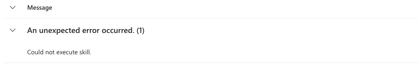

The indexer produces this error on EVERY documents in the SharePoint:
After some test, I identified that my custom skill is working fine and that the error is produced by the DocumentLayoutIntelligenceSkill.

I checked the logs of my function during indexer execution and the url are valid (I can access them). Do I need to give special rights in my skillset to access the sharepoint ? Knowing that that my Azure AI Search resource already has the permissions. Since debug plateform is not available for SharePoint datasource, I am pretty stuck at this point without any ways to get more information on the reason of this error.
Do you have any idea on what could cause such error ? I have already discarded custom skill, file size and extension (since not a single file pass the skill). My guess is on the authorization to download the file from the url for the skill but I have no way to confirm it.
