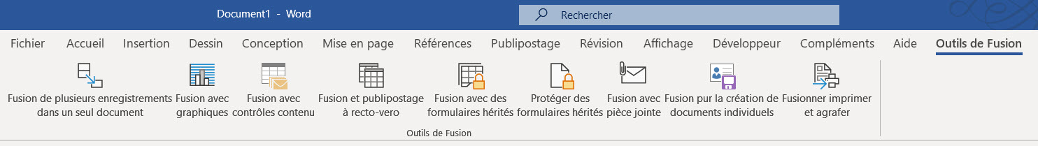

    It is indeed a good idea to make a french language interface. I will tell you my comments by private email.
    There is  a tool, in particulier, that will interest a lot of people, it is the merge with Attachment.
    Could you allow me to relay your tool on my website ? (http://faqword.com).
    I just installed your tool, and without really doing a test, if I click a button of the Merge Tools tab, I always obtain an error 13. Can you look what is the reason?

    On this subject, I have been requested to create a French Language interface for my Merge Tools and would be grateful for your comments on what I have come up with
