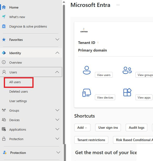

      1. Sign in to the Microsoft Entra Admin Center – Go to Microsoft Entra Admin Center and log in with admin credentials.
      2. Go to User Authentication Settings – Navigate to Identity > Users > All Users.

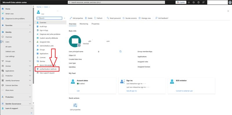

      3. Select the Affected Users – Choose the accounts that need reconfiguration.

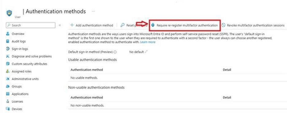

      4. Go to authentication method ->require re-register MFA.
      5. Verify & Complete Setup – You can now log-in and set up your authenticator app again.
