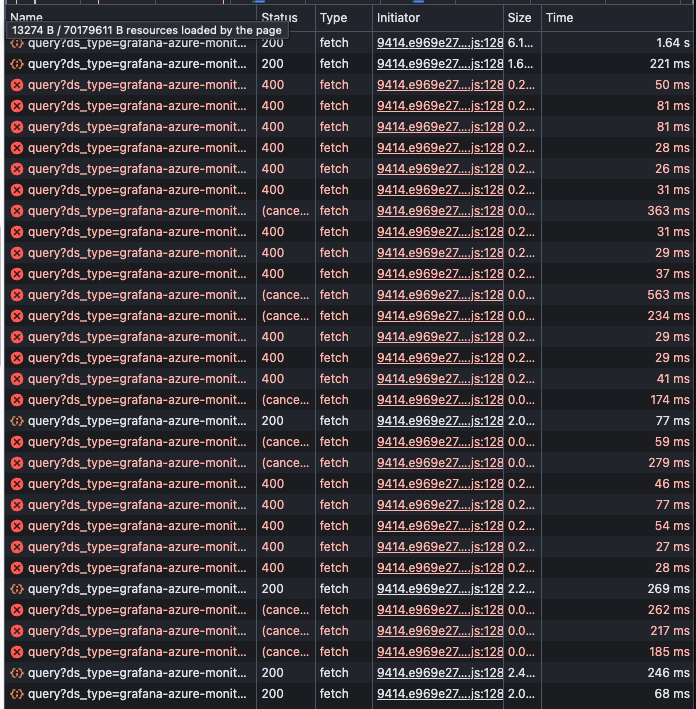

Since 3 days some cells of my Dashboards with Grafana (preview) on Azure Portal return 400 'bad request'.
This is what I tested :
  • Create a new cell and copy/past the query -> works, but I don't want to do this manual step for all my cells.
  • Some requests are working while others not on the Azure Portal website (see screenshot). When copy/pasting request that fails in Postman they actually works.

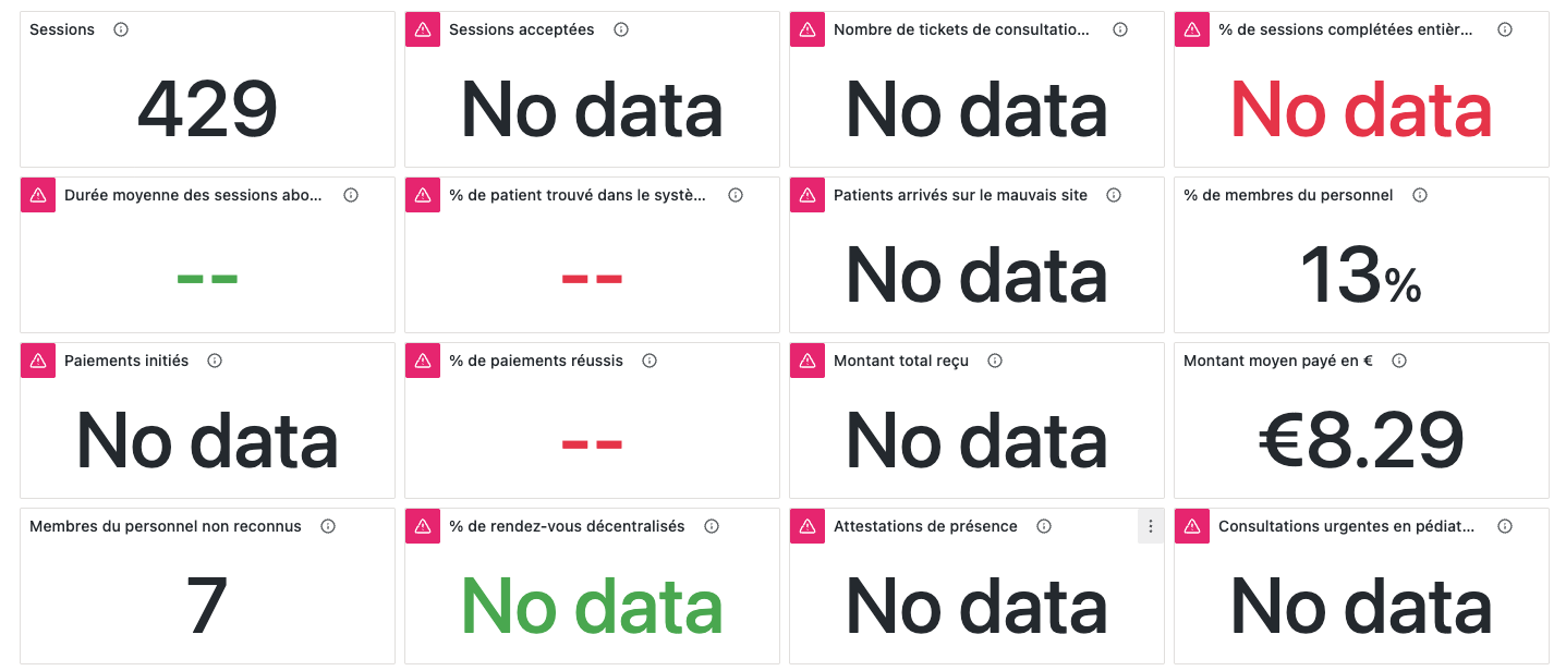

    Hello,
    Just found the root cause.
    When a title contains an accent char it fails.
    Image de l’utilisateur
    Remove accents will do the trick.
