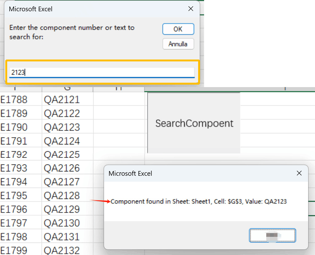

    Siamo spiacenti, il bot di traduzione incasina sempre il codice, guarda il codice della seconda risposta qui:
    Sub SearchComponent()
    Dim searchValue As String
    Dim ws As Worksheet
    Dim cell As Range
    Dim found As Boolean
    found = False
    ' Prompt the user to enter the component number or text to search for
    searchValue = InputBox("Enter the component number or text to search for:")
    ' Loop through each worksheet
    For Each ws In ThisWorkbook.Sheets
        For Each cell In ws.Range("A1:G48")  ' Modify this range as needed
            If InStr(1, cell.Value, searchValue, vbTextCompare) > 0 Then  ' Fuzzy matching
                ' Output the results in a message box or to a specific cell
                MsgBox "Component found in Sheet: " & ws.Name & ", Cell: " & cell.Address & ", Value: " & cell.Value
                found = True
                Exit Sub
            End If
        Next cell
    Next ws
    If Not found Then
        MsgBox "Component not found."
    End If
    End Sub

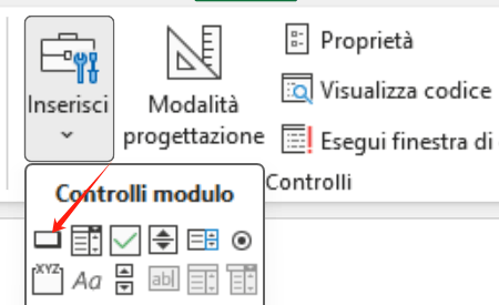

    1. Aprire la cartella di lavoro di Excel.
    2. Inserire un pulsante:
