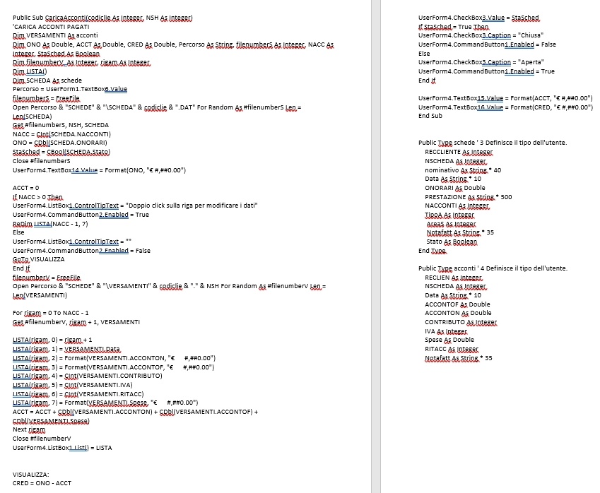

    nel precedente post non sono riuscito a mandare il codice quindi ho allegato l'immagine, ora ho capito la procedura e lo rimando:
    Public Sub CaricaAcconti(codiclie As Integer, NSH As Integer)
    Dim VERSAMENTI As acconti
    Dim ONO As Double, ACCT As Double, CRED As Double, Percorso As String, filenumberS As Integer, NACC As Integer, StaSched As Boolean
    Dim filenumberV  As Integer, rigam As Integer
    Dim LISTA()
    Dim SCHEDA As schede
    Percorso = UserForm1.TextBox6.Value
    filenumberS = FreeFile
    Open Percorso & "SCHEDE" & "\SCHEDA" & codiclie & ".DAT" For Random As #filenumberS Len = Len(SCHEDA)
    Get #filenumberS, NSH, SCHEDA
    NACC = CInt(SCHEDA.NACCONTI)
    ONO = CDbl(SCHEDA.ONORARI)
    StaSched = CBool(SCHEDA.Stato)
    Close #filenumberS
    UserForm4.TextBox14.Value = Format(ONO, "€ #,##0.00")
    ACCT = 0
    If NACC > 0 Then
    UserForm4.ListBox1.ControlTipText = "Doppio click sulla riga per modificare i dati"
    UserForm4.CommandButton2.Enabled = True
    ReDim LISTA(NACC - 1, 7)
    Else
    UserForm4.ListBox1.ControlTipText = ""
    UserForm4.CommandButton2.Enabled = False
    GoTo VISUALIZZA
    End If
    filenumberV = FreeFile
    Open Percorso & "SCHEDE" & "\VERSAMENTI" & codiclie & "." & NSH For Random As #filenumberV Len = Len(VERSAMENTI)
    For rigam = 0 To NACC - 1
    Get #filenumberV, rigam + 1, VERSAMENTI
    LISTA(rigam, 0) = rigam + 1
    LISTA(rigam, 1) = VERSAMENTI.DataPag
    LISTA(rigam, 2) = Format(VERSAMENTI.ACCONTON, "€      #,##0.00")
    LISTA(rigam, 3) = Format(VERSAMENTI.ACCONTOF, "€      #,##0.00")
    LISTA(rigam, 4) = CInt(VERSAMENTI.CONTRIBUTO)
    LISTA(rigam, 5) = CInt(VERSAMENTI.IVA)
    LISTA(rigam, 6) = CInt(VERSAMENTI.RITACC)
    LISTA(rigam, 7) = Format(VERSAMENTI.Spese, "€      #,##0.00")
    ACCT = ACCT + CDbl(VERSAMENTI.ACCONTON) + CDbl(VERSAMENTI.ACCONTOF) + CDbl(VERSAMENTI.Spese)
    Next rigam
    Close #filenumberV
    UserForm4.ListBox1.List() = LISTA
    VISUALIZZA:
    CRED = ONO - ACCT
    UserForm4.CheckBox3.Value = StaSched
    If StaSched = True Then
    UserForm4.CheckBox3.Caption = "Chiusa"
    UserForm4.CommandButton1.Enabled = False
    Else
    UserForm4.CheckBox3.Caption = "Aperta"
    UserForm4.CommandButton1.Enabled = True
    End If
    UserForm4.TextBox15.Value = Format(ACCT, "€ #,##0.00")
    UserForm4.TextBox16.Value = Format(CRED, "€ #,##0.00")
    End Sub
    Public Type schede ' 3 Definisce il tipo dell'utente.
        RECCLIENTE As Integer
        NSCHEDA As Integer
        nominativo As String * 40
        DataInc As String * 10
        ONORARI As Double
        PRESTAZIONE As String * 500
        NACCONTI As Integer
        TipoA As Integer
         AreaS As Integer
         Notafatt As String * 35
         Stato As Boolean
    End Type
    Public Type acconti ' 4 Definisce il tipo dell'utente.
        RECLIEN As Integer
        NSCHEDA As Integer
        DataPag As String * 10
        ACCONTOF As Double
        ACCONTON As Double
        CONTRIBUTO As Integer
        IVA As Integer
        Spese As Double
        RITACC As Integer
    End Type
    L'errore si verifica nel rigo 10 del codice. Leggendo l'articolo ufficiale su questo errore, mi sembra di capire che la dimensione del file si modifica in fase di memorizzazione dei record (Put), ma non dovrebbe mantenere le dimensioni impostate nella struttura del file? Grazie Giorgio

    Senza file è difficile, inoltre al posto del codice alleghi un'immagine, senza nemmeno dire quale riga va in errore, complicando così la comprensione dello stesso e la possibile soluzione:
    in questa parte la definizione di Len porta a quell'errore, come evidenziato in quest'articolo ufficiale.
