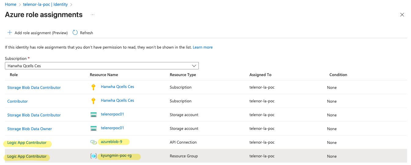

1. Ensure the Logic App is using a managed identity (System-assigned or User-assigned)
2. Assign correct RBAC roles

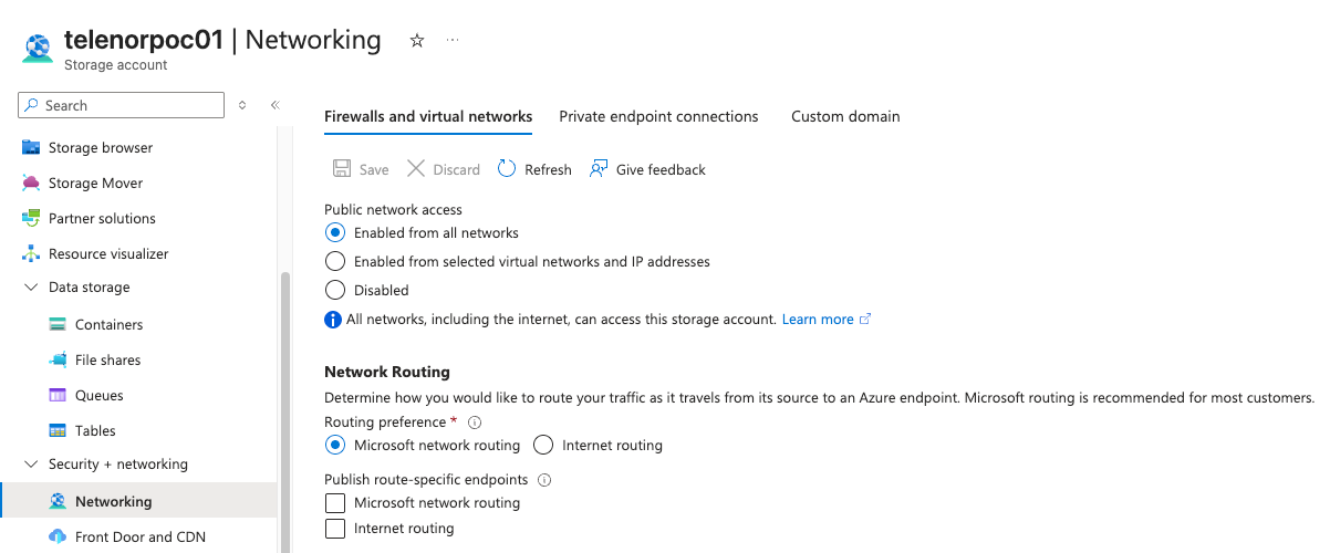

4. Check VNET integration and firewall

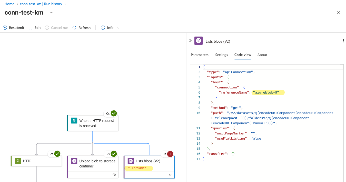

Details of the List Blob (V2) action and the 403 error information:
- Work Flow Information (List Blob (V2))
- List Blob (V2) Action Outputs Info.
- Status Code: 403
- Body
{ "status": 403, "source": "https://logic-apis-koreacentral-001.token.azure-apim.net:443/tokens/logic-apis-koreacentral-001/b49b6997c0a44d42/azureblob/a706ca63e69f4b73a54fe0cbf3588452/exchange", "message": "Error from token exchange: Permission denied due to missing connection ACL: User = 435c1340-f832-4d68-a6b4-f1ac239d1ba3@f67255a8-0525-4454-88a6-bf4216fffc68 appid=9990609e-58ce-49ba-8b0a-b27127423d1c, connection=logic-apis-koreacentral-001/b49b6997c0a44d42/azureblob/a706ca63e69f4b73a54fe0cbf3588452" }For reference, I confirmed that it’s possible to obtain an Azure AD token via an HTTP call and use that token to create a file in Storage. However, what I want is to handle this with a single action using V2 authentication.

김경민 • 40 평판 포인트
2025-07-16T00:31:07.06+00:00 Hi, @Krishna Chowdary Paricharla
Even after assigning permissions to the API Connection resource and granting the Logic App Contributor role to the Resource Group containing the API Connection, the same error persists.
Additionally, I tried creating and testing new authentication configurations using both Managed Identity and Service Principal, but the issue remains unchanged.
Could you check if there are any other settings or restrictions that might be causing this?
I’ll attach images of the steps I’ve tried:
- Logic App Contributor role assignment
- Workflow Run History after the role assignment
