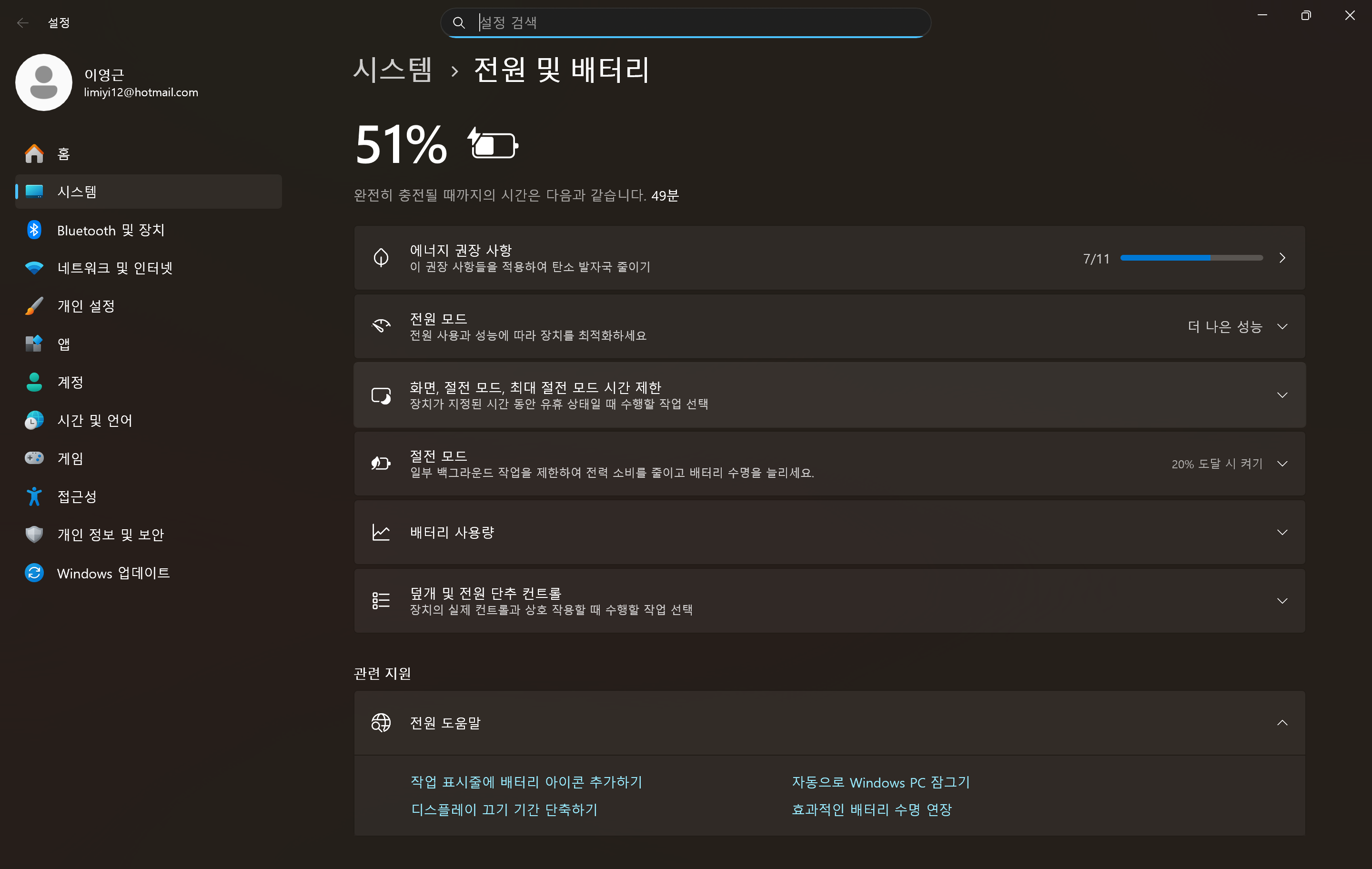

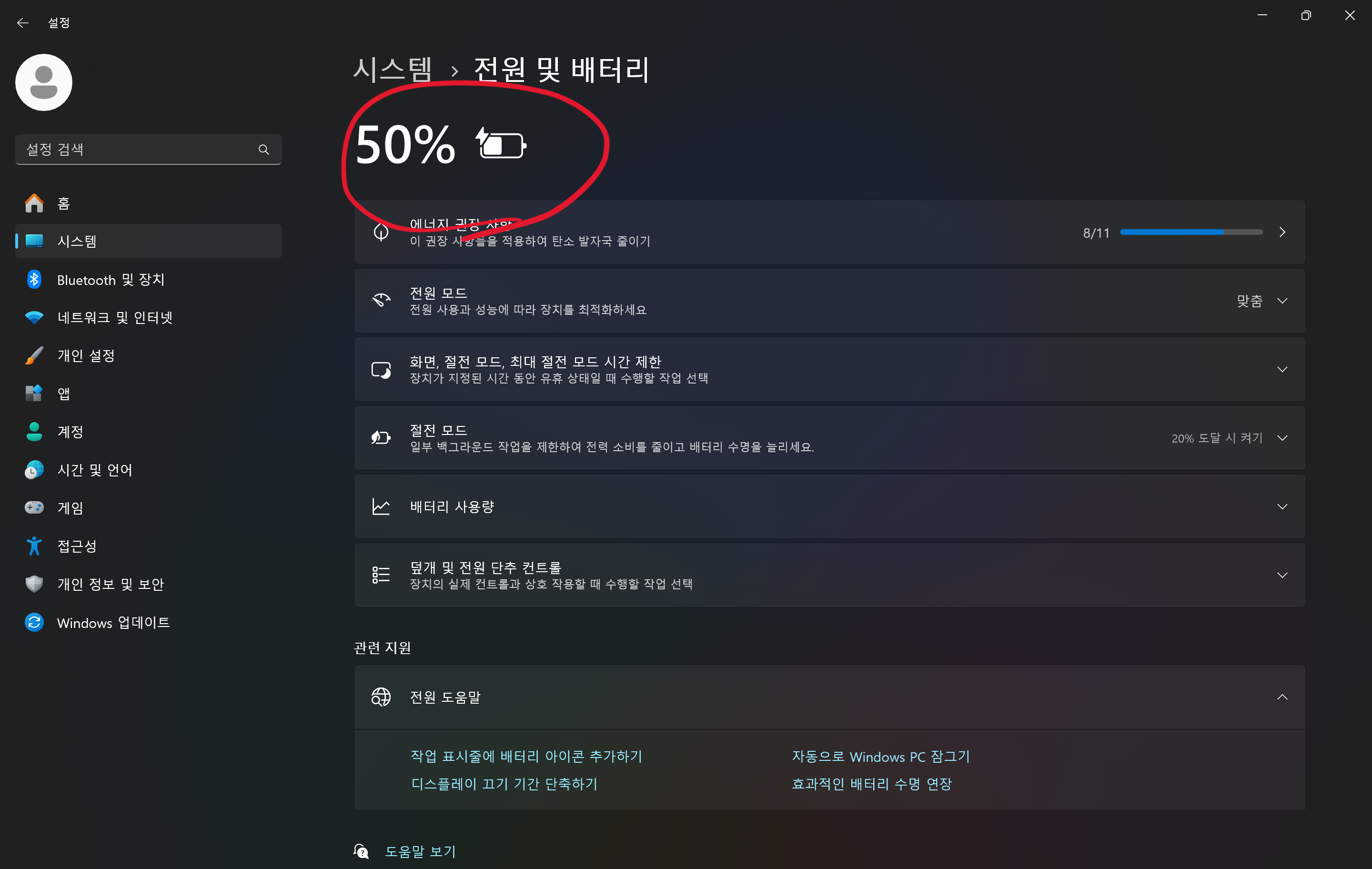

Yesterday, I was trying to deactivate 'Battery Limit' feature on my Surface Pro 11 but I was not able to find 'Enable Battery Limit' toggle switch on Surface UEFI > Boot Configuration. and still its battery can be charged only up to 50%.20250811_040110스크린샷 2025-08-11 052945

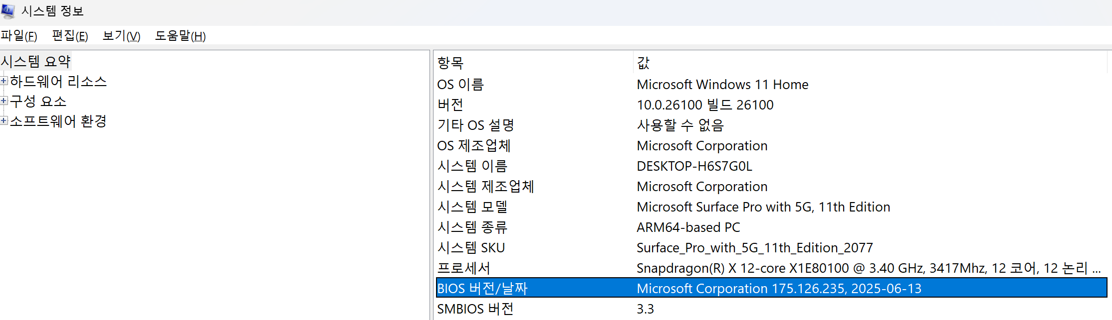

  1. System info : Surface Pro 11 / Window 11 Home Arm 64 (10.0 Build 26100) / Bios 175.126.235

Under these Circumstance, Is there any further action to solve this problem? Please advise me. Thank you for your hard work in advance.

    Thanks for the heads-up that sounds super frustrating. You’ve already done a great job narrowing it down, especially noticing that the Battery Limit option is gone from UEFI but the system still won’t charge past 50%. That’s definitely not how it should behave, especially after selecting the 80% profile in Windows.
