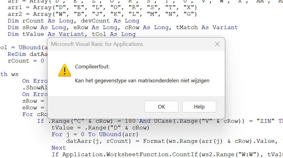

    I'm getting a new error. Translated it say: "Compile error: Can't change the data type of matrixparts(??)
    Looks like i cant attach the file in the reply.

    Please try this: Sub Results1() Dim ws As Worksheet, ws2 As Worksheet Set ws = ThisWorkbook.Worksheets("XW") Set ws2 = ThisWorkbook.Worksheets("ZL") Dim arr, arr2 Dim arr1, datAarr() arr = Array("D", "E", "L", "O", "R", "S", "T", "U", "V", "W", "X", "AA", "AB") arr1 = Array("D", "E", "L", "O", "R", "S", "T", "X") arr2 = Array("W", "B", "J", "K", "L", "M", "N", "G") Dim rCount As Long, devCount As Long Dim sRow As Long, eRow As Long, cRow As Long, tMatch As Variant Dim tValue As Variant, tCol As Long
    tCol = UBound(arr) + UBound(arr1) + 1 ReDim datAarr(0 To tCol, 0 To 0) As String rCount = 0
    With ws On Error Resume Next . ShowAllData On Error GoTo 0 sRow = 2 eRow = . Range("A" & . Rows.Count). End(xlUp). Row For cRow = sRow To eRow If . Range("C" & cRow) = 180 And UCase(. Range("V" & cRow)) = "ZIN" Then tValue = . Range("D" & cRow) For j = 0 To UBound(arr) datAarr(j, rCount) = Format(ws. Range(arr(j) & cRow). Value, "dd-mm-yyyy") Next If Application.WorksheetFunction.CountIf(ws2. Range("W:W"), tValue) Then tMatch = Application.WorksheetFunction.Match(tValue, ws2. Range("W:W"), 0) For j = 0 To UBound(arr1) If ws. Range(arr1(j) & cRow) <> ws2. Range(arr2(j) & tMatch) Then devCount = devCount + 1 datAarr(UBound(arr) + 1 + j, rCount) = ws2. Range(arr2(j) & tMatch) End If Next If devCount > 0 Then rCount = rCount + 1 ReDim Preserve datAarr(tCol, rCount) As String devCount = 0 End If Else datAarr(UBound(arr) + 1, rCount) = "False" rCount = rCount + 1 ReDim Preserve datAarr(tCol, rCount) As String End If End If Next End With
