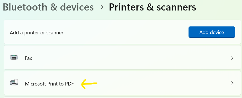

    1.The "PDF Isolation" Test.
    • Close AFAS completely. Go to Settings > Bluetooth & devices > Printers & scanners.
    • Afbeelding van gebruiker
    • Find "Microsoft Print to PDF" (or any PDF writer). Click on it and select Set as default. Note: If you do not see the button, you must first turn off "Let Windows manage my default printer" (see step 2).
    • Open AFAS and try to print the document again.
    • If it works: The issue is most likely your physical printer driver. You can print to PDF first and then print that PDF to paper, or try reinstalling your specific printer driver with a Windows 11-compatible version.
