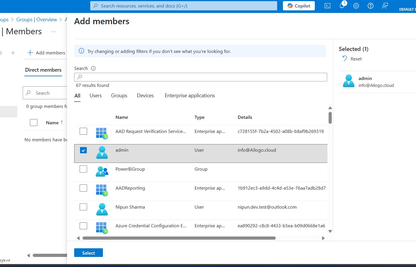

    I'm also facing the same blocker due to non presence of Application permissions in my app (only delegated permissions are available).
    I tried following steps from your comment above but I'm facing another problem, while trying to add a user to the security Group there is no "Service Principle" available in the list
    Imagem do usuário
    What should I do to resolve this issue? Your soonest response is awaited as my project is blocked as of now.

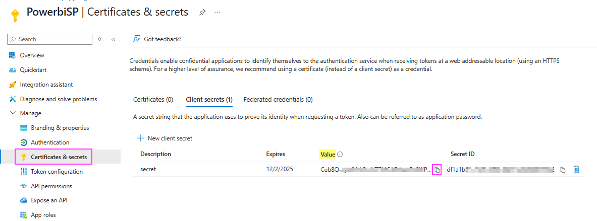

    Initially, register one Microsoft Entra application and create one client secret in it:

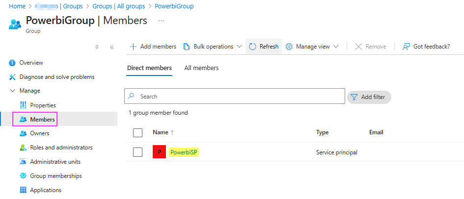

    Then, create a security group in Microsoft Entra ID and add service principal to the group to grant access to Power BI content:

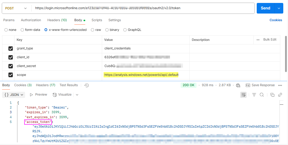

    Now, authenticate using client credentials (client ID and client secret) to obtain an access token from Microsoft Entra ID.

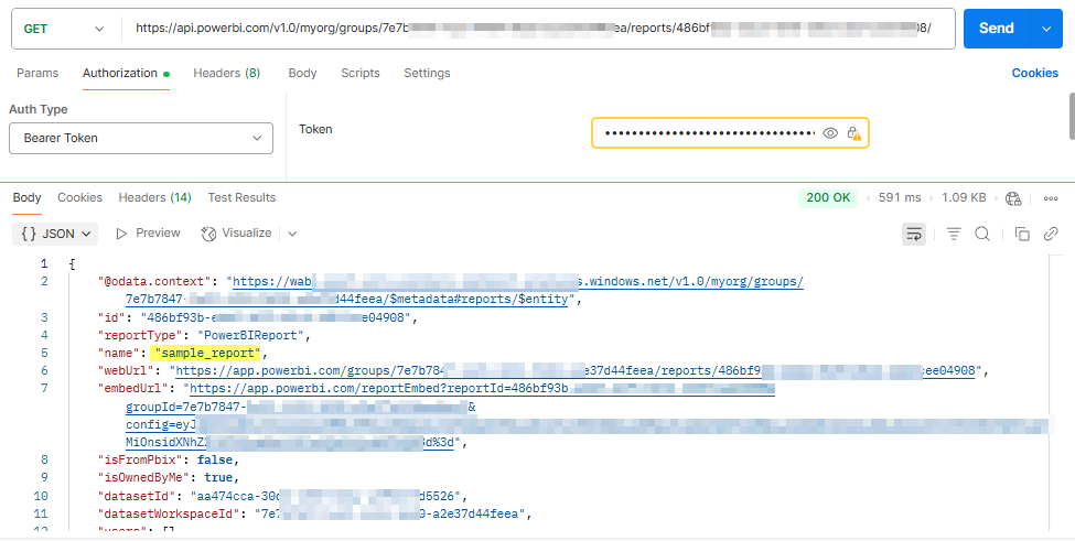

    Once authenticated, your service principal can query Power BI data like reports using the Power BI API.
    GET https://api.powerbi.com/v1.0/myorg/groups/{groupid}/reports/{reportid}/
