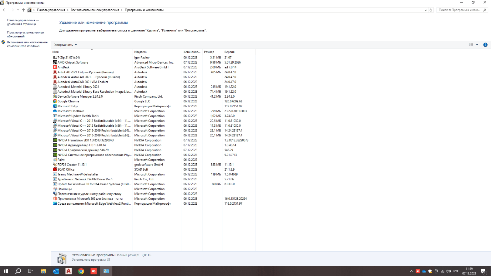

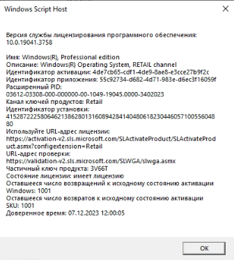

  2. Анонимные
    2023-12-07T09:02:50+00:00
    Скриншоты прилагаю.
    1.
    2.

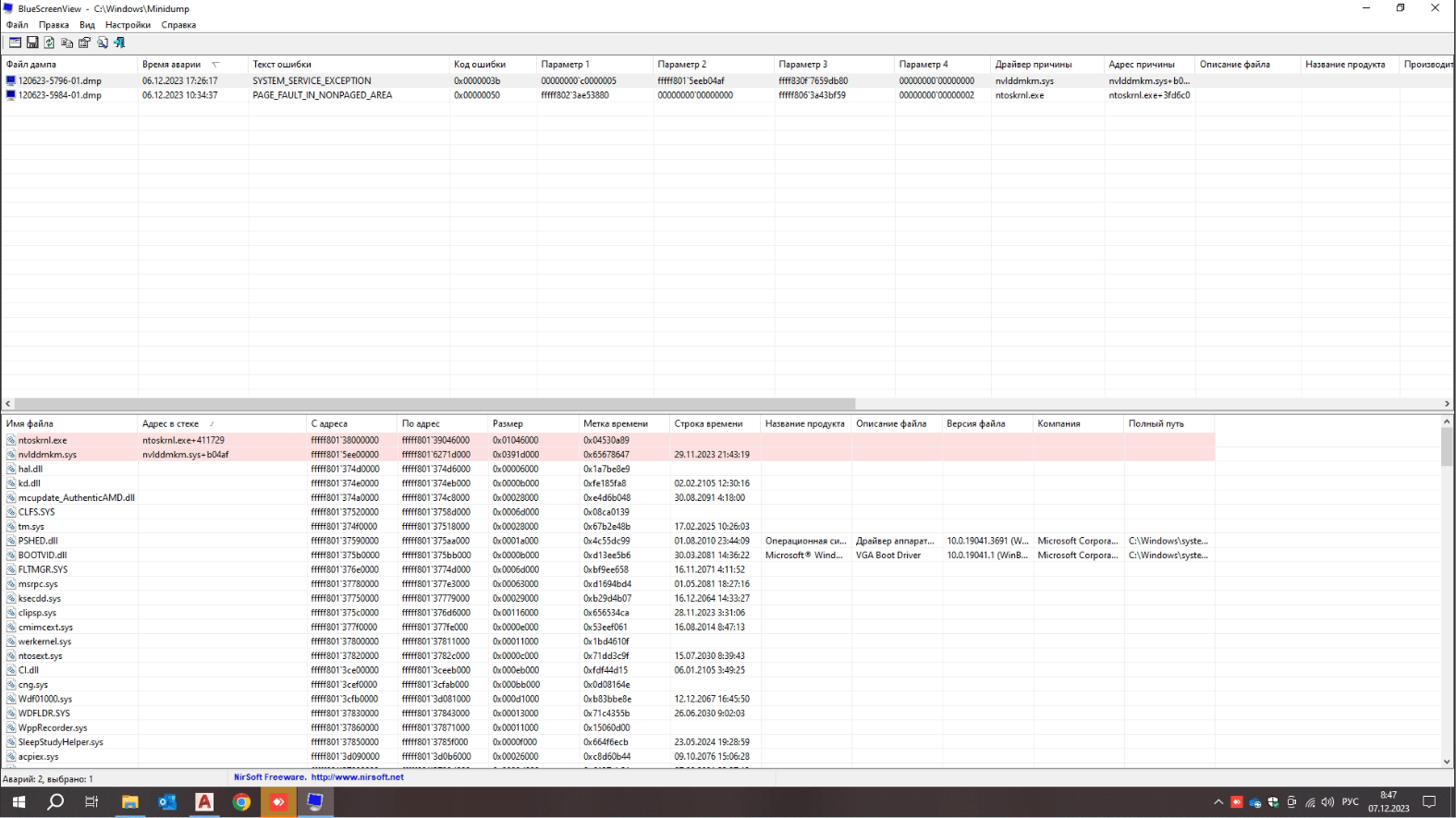

  3. Анонимные
    2023-12-07T08:47:14+00:00
    [120623-5984-01.dmp]
    PAGE_FAULT_IN_NONPAGED_AREA (50)
    Invalid system memory was referenced. This cannot be protected by try-except.
    Typically the address is just plain bad or it is pointing at freed memory.
    Arguments:
    Arg1: fffff8023ae53880, memory referenced.
    Arg2: 0000000000000000, X64: bit 0 set if the fault was due to a not-present PTE.
    bit 1 is set if the fault was due to a write, clear if a read.
    bit 3 is set if the processor decided the fault was due to a corrupted PTE.
    bit 4 is set if the fault was due to attempted execute of a no-execute PTE.
    - ARM64: bit 1 is set if the fault was due to a write, clear if a read.
    bit 3 is set if the fault was due to attempted execute of a no-execute PTE.
    Arg3: fffff8063a43bf59, If non-zero, the instruction address which referenced the bad memory
    address.
    Arg4: 0000000000000002, (reserved)
    PROCESS_NAME: MsMpEng.exe
    MODULE_NAME: nt
    IMAGE_NAME: ntkrnlmp.exe
    IMAGE_VERSION: 10.0.19041.3758
    [120623-5796-01.dmp]
    SYSTEM_SERVICE_EXCEPTION (3b)
    An exception happened while executing a system service routine.
    Arguments:
    Arg1: 00000000c0000005, Exception code that caused the BugCheck
    Arg2: fffff8015eeb04af, Address of the instruction which caused the BugCheck
    Arg3: ffff830f7659db80, Address of the context record for the exception that caused the BugCheck
    Arg4: 0000000000000000, zero.
    PROCESS_NAME: explorer.exe
    MODULE_NAME: nvlddmkm
    IMAGE_NAME: nvlddmkm.sys
    Тут сразу несколько проблем...
    Выложите здесь скриншоты:
    1. Окна Панель управления-Программы и компоненты со списком всех установленных программ.
    2. Окна команды slmgr.vbs /dlv
