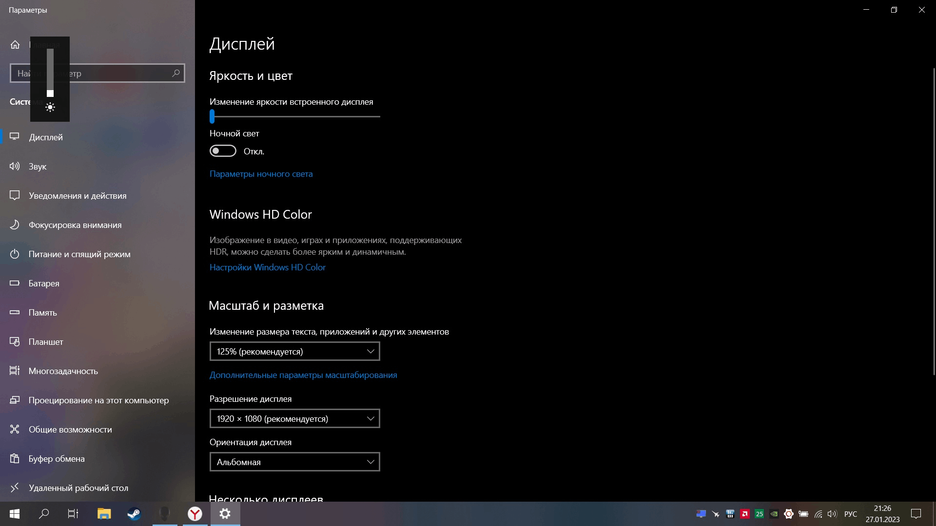

Помогите, пожалуйста. Не работает регулировка яркости на ноутбуке dell g15 5515 ryzen edition. В панели задач не отображается. В параметрах экрана, в настройках, при нажатии клавиш отображается изменение уровня яркости, но фактически ничего не меняется. Постоянно максимальная яркость, что доставляет ряд неудобств. Устанавливал драйвера через DriverHub, переустанавливал windows, не работает.

2. It is not displayed in the taskbar. In the screen settings, in the settings, when you press the keys (F6 and F7 on the laptop are responsible for brightness), a change in the brightness level is displayed, but in fact nothing changes, the maximum brightness is constantly. I tried to adjust it on the integrated graphics through the AMD application, through the control panel it is regulated only when OPTIMUS is disabled (attachment - control panel with OPTIMUS enabled)

With optimus turned on, there is simply no "display" section in the nvidia control panel where the adjustment should be.
AMD does not adjust the brightness, the color brightness settings work, but this is clearly not what I need:(
When I turn off the device (integrated graphics), the ability to change the brightness disappears - keystrokes do not give any result.Staff Account (Soumya Ravi) via channel 'Email'01/29/2023 12:46 PM Hello,
