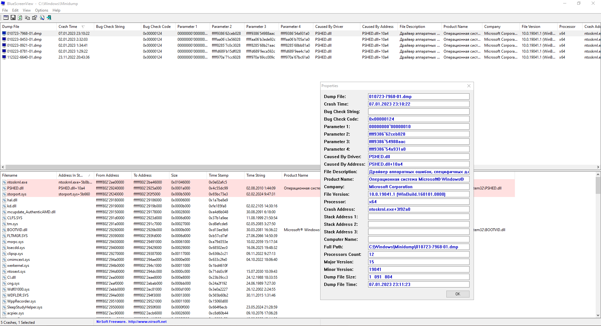

Доброго времени суток, в тяжелых играх ловлю синие экраны с ошибкой whea uncorrectable error, блюскринвьювер ругается на PSHED.dll

    Анализ дампов показывает, что у Вас есть довольно высокая вероятность наличия аппаратных проблем:
    On Sat 07.01.2023 21:10:22 your computer crashed or a problem was reported
    crash dump file: C:\TMP\DUMP\MEMORY.DMP
    This was probably caused by the following module: storport.sys (storport!StorPortWriteRegisterUshort+0x93A1)
    Bugcheck code: 0x124 (0x10, 0xFFFF938662CEB028, 0xFFFF938654988AAC, 0xFFFF938654A931A0)
    Error: WHEA_UNCORRECTABLE_ERROR
    file path: C:\WINDOWS\system32\drivers\storport.sys
    product: Microsoft:registered: Windows:registered: Operating System
    company: Microsoft Corporation
    description: Microsoft Storage Port Driver
    Bug check description: This bug check indicates that a fatal hardware error has occurred. This bug check uses the error data that is provided by the Windows Hardware Error Architecture (WHEA).
    This is likely to be caused by a hardware problem.
    The crash took place in a storage driver or controller driver. Since there is no other responsible driver detected, this could be pointing to a malfunctioning drive or corrupted disk. It's suggested that you run CHKDSK.
    crash dump file: C:\TMP\DUMP\010723-7968-01.dmp
    This was probably caused by the following module: ntoskrnl.exe (nt+0x3F92A0)
    file path: C:\WINDOWS\system32\ntoskrnl.exe
    description: NT Kernel & System
    The crash took place in the Windows kernel. Possibly this problem is caused by another driver that cannot be identified at this time.
    On Mon 02.01.2023 0:32:03 your computer crashed or a problem was reported
    crash dump file: C:\TMP\DUMP\010223-8453-01.dmp
    Bugcheck code: 0x124 (0x10, 0xFFFFAA06C3E56028, 0xFFFFAA06B3EDE92C, 0xFFFFAA06B705A1A0)
    On Sun 01.01.2023 23:34:41 your computer crashed or a problem was reported
    crash dump file: C:\TMP\DUMP\010223-8921-01.dmp
    Bugcheck code: 0x124 (0x10, 0xFFFF82857C0C3028, 0xFFFF828568B21AAC, 0xFFFF828568BB81A0)
    On Sun 01.01.2023 23:29:22 your computer crashed or a problem was reported
    crash dump file: C:\TMP\DUMP\010223-8781-01.dmp
    Bugcheck code: 0x124 (0x10, 0xFFFFD689B15DF028, 0xFFFFD6899ECA592C, 0xFFFFD6899EE4C1A0)
