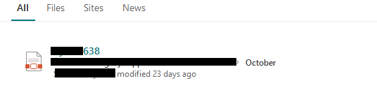

For a document in SharePoint online library modified date is incorrect in search result and correct in document library.  What is interesting, user claimed that same document was uploaded couple of weeks before but mysteriously disappeared.

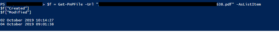

I tried to remove document url from search and re-index the library. Event after waiting 48 hours document didn't show up in search. So I modified document's property to  see if incremental search pick-up the same and it did but modified date is still old in search result and modified by was updated.

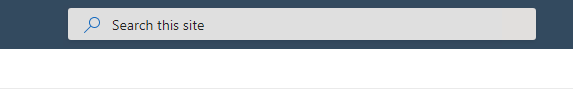

    After doing some tests, it seems to be a crawl issue with the PDF files in SharePoint Online and the PDF files’ properties seem to be unable to be crawled when using the site search box in SharePoint Online.

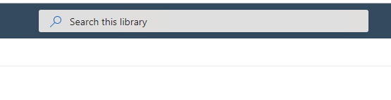

    Based on my test, the library search box seems to get the right result. I also suggest you use the library search box in SharePoint Online to search the PDF files to see the result in your environment.

    Thanks for your response,  the issue only happens in a specific file and the result is same in modern and classic search. I found the cause of the issue the modified property value is coming from pdf document properties. (These are pdf files)

    Meanwhile, if you search the file with the search box in the library where the affected files are, will the issue happen?

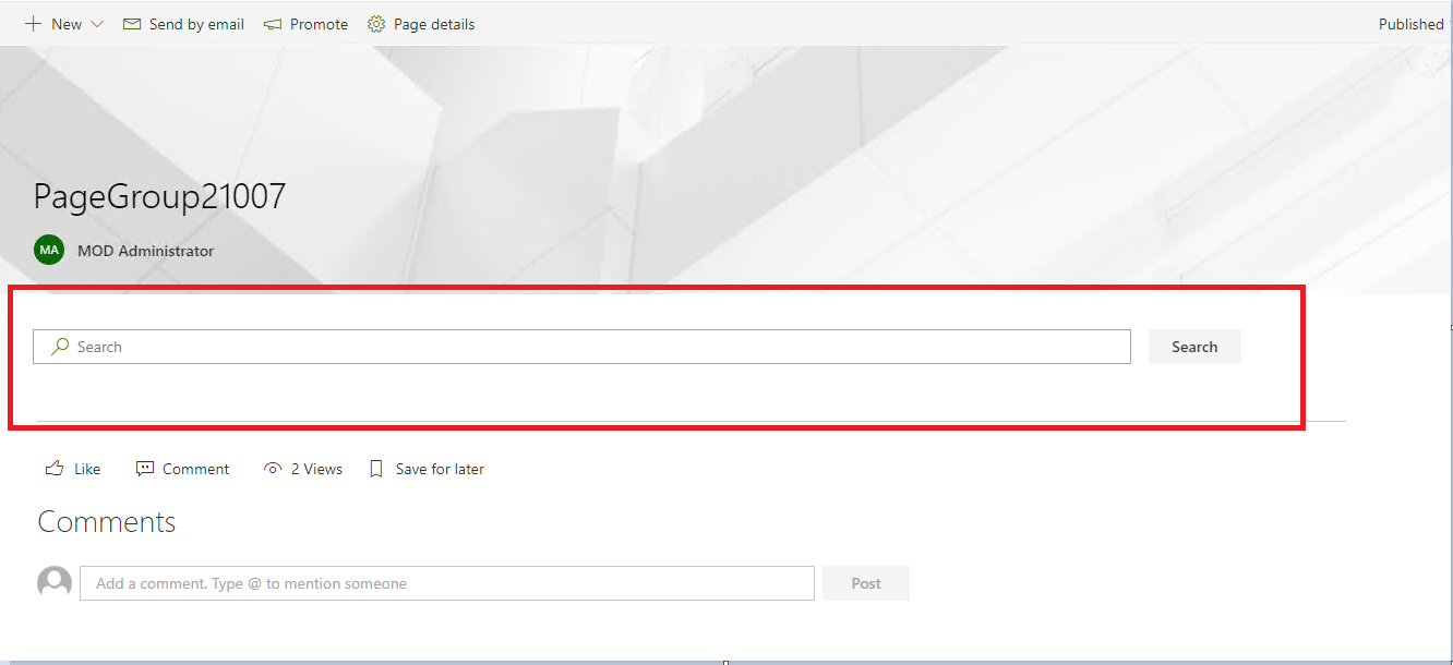

    To improve the search experience on the modern page, I suggest you use the Search box web part for the modern site page to see if the issue goes away when using the web part in your environment.
    If you are using the  Office 365 group site, first enable custom script with SharePoint Online Management Shell on the site via the steps in the article. Then go to the new SharePoint admin center>Classic features>Apps>App Catalog>create an app catalog and then upload the Modern Search Box web part there. After doing that, you can add the web part app in Site contents.
    To get the package, you can follow the similar steps in the article. I have sent the package in the private message for your deployment. If you can’t deploy it to your environment, follow the steps in the articleand deploy the package to your environment.
