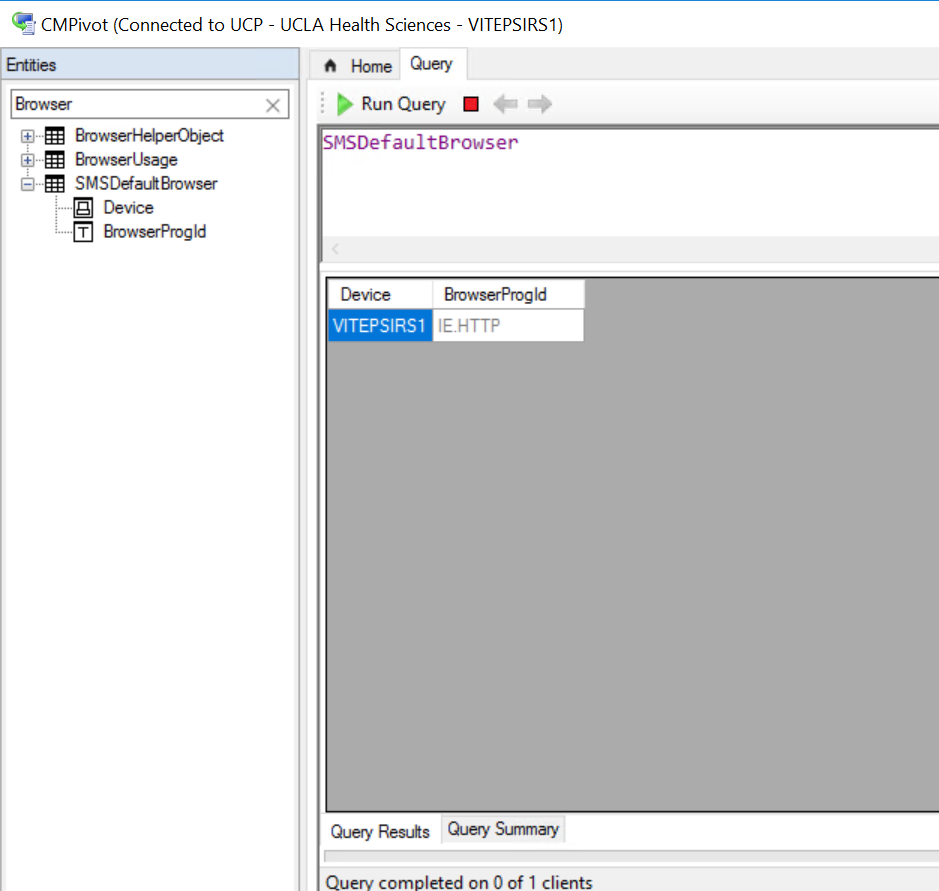

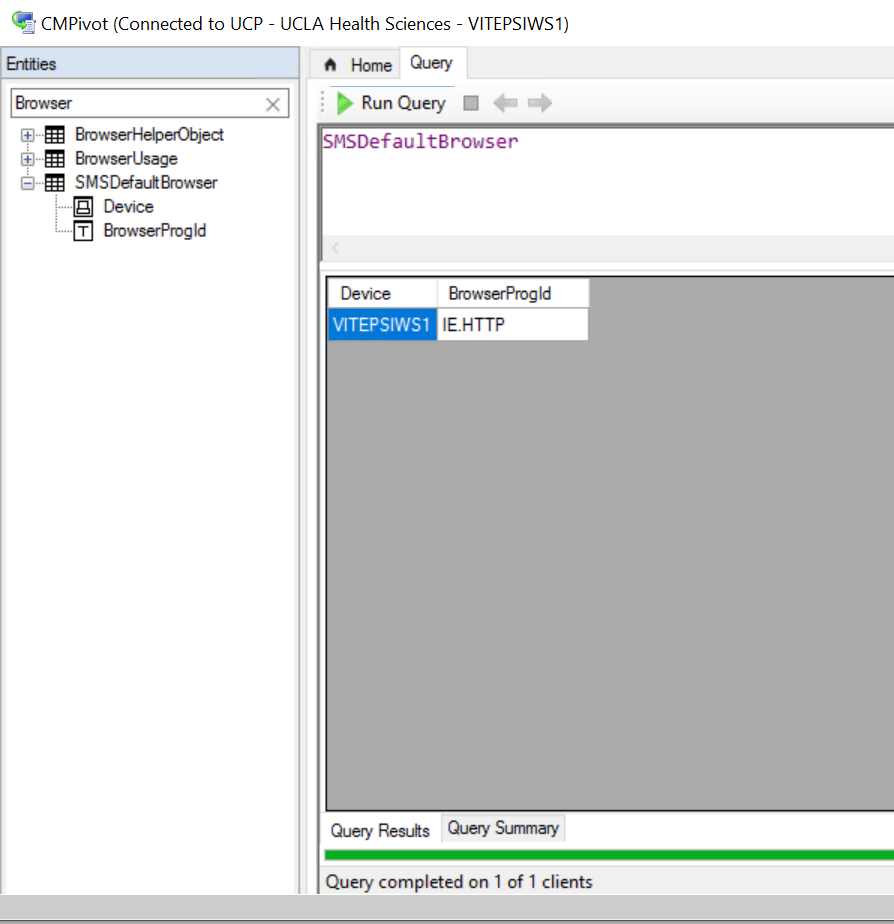

    Our tests are:
    1. When the CMPivot SMSDefaultBrowser is launched on 1 Machine ONLINE it completes in seconds...
    2. When the CMPivot SMSDefaultBrowser is launched on 1 Machine OFFLINE it never completes, I waiting hours and the job/task is still in progress 0 of 1 ...?
    3. I checked the event logs on both machine Applications and Services Logs > Microsoft > Windows > Powershell > Operational
      3.a Machine online:
