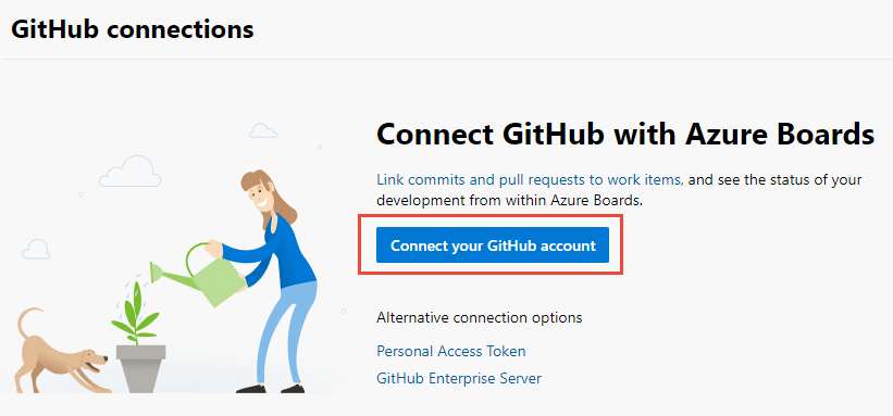

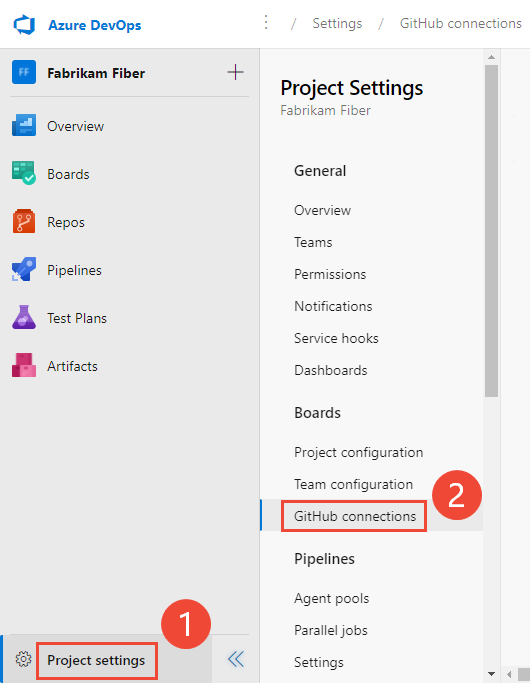

Sign in to your project (
https://dev.azure.com/{Your_Organization/Your_Project}).Select Project settings > GitHub connections.
For a first-time connection, select Connect your GitHub account to authenticate with your GitHub credentials.

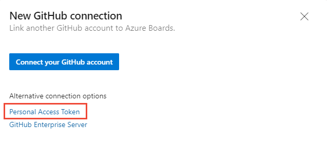

For subsequent connections, select
New connection and choose your authentication method.To connect with a PAT instead, see Add a GitHub connection using PAT. For GitHub Enterprise Server, see Register Azure DevOps in GitHub as an OAuth App.

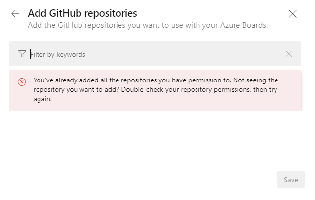

If all repositories for an organization are already connected, the following message appears:

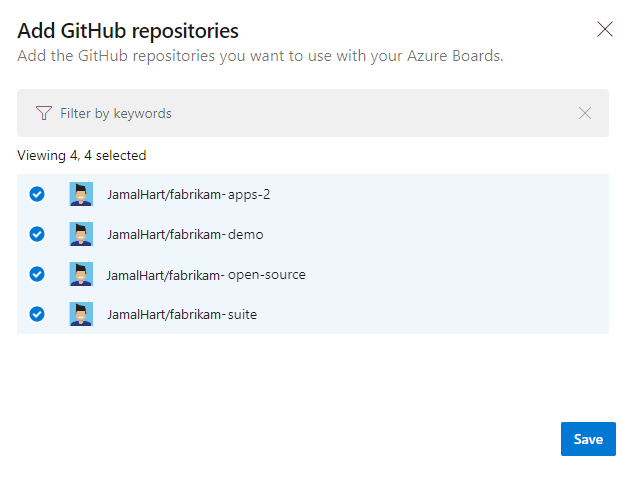

After you authenticate, select the repositories to connect.
The Add GitHub Repositories dialog displays and preselects all repositories where you're an administrator in the selected organization. Clear any repositories you don't want to connect.

If all repositories are already connected to the current or another organization, the following message appears:
Select Save.

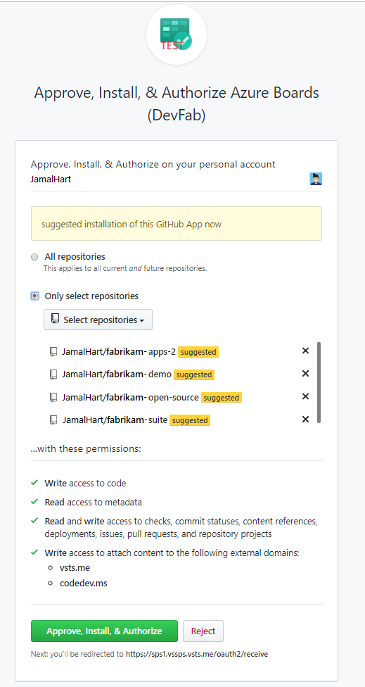

Confirm the connection
On the GitHub page, select Approve, Install, & Authorize.
Enter your GitHub credentials to confirm.

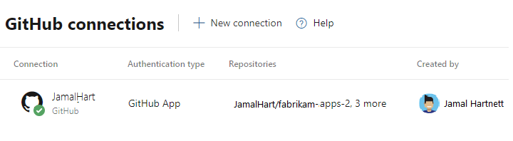

The new connection displays with the selected repositories listed.
To change the configuration or manage the Azure Boards app for GitHub, see Change repository access to Azure Boards.

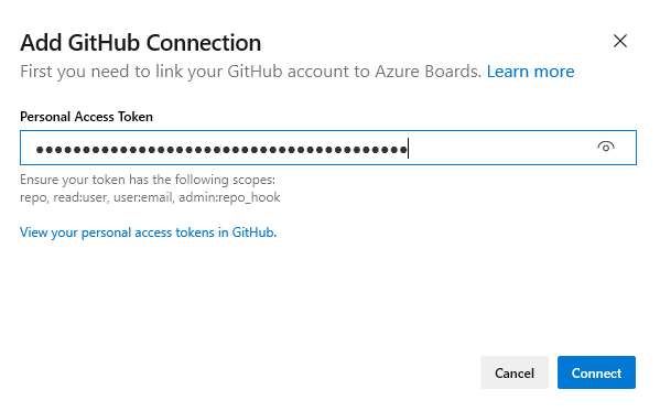

Select Personal Access Token in the New Connection dialog.
To create a GitHub PAT, go to GitHub Developer Settings > Personal access tokens.
Enter the PAT and select Connect.
Select the repositories to connect. For details, see Add GitHub repositories.

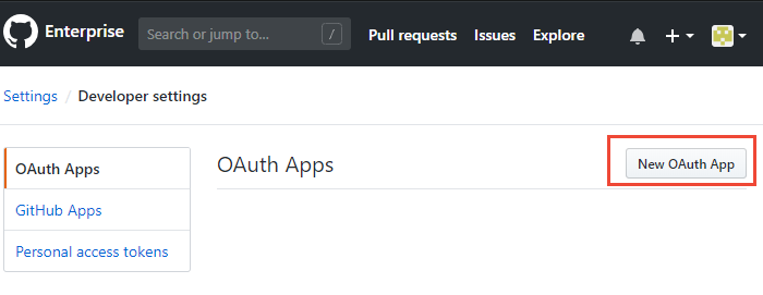

Sign in to the web portal for your GitHub Enterprise Server.

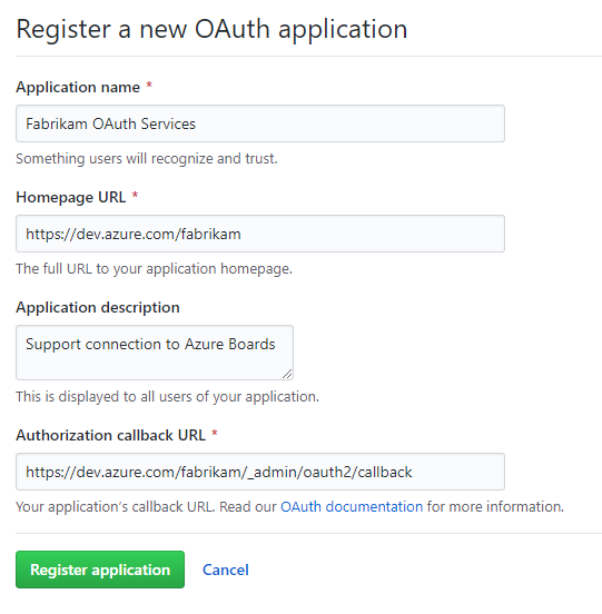

Open Settings > Developer settings > Oauth Apps > New OAuth App.
Enter registration information.
- Homepage URL — Your organization URL.
- Authorization callback URL — Use the pattern
{Organization URL}/_admin/oauth2/callback. For example:https://dev.azure.com/fabrikam/_admin/oauth2/callback

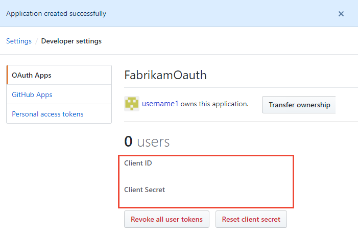

Select Register application.
Copy the Client ID and Client Secret that appear for your registered OAuth application.

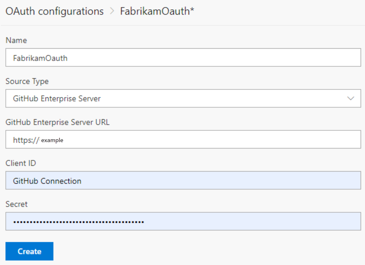

Register your OAuth configuration in Azure DevOps Services
Sign in to the web portal for Azure DevOps Services.

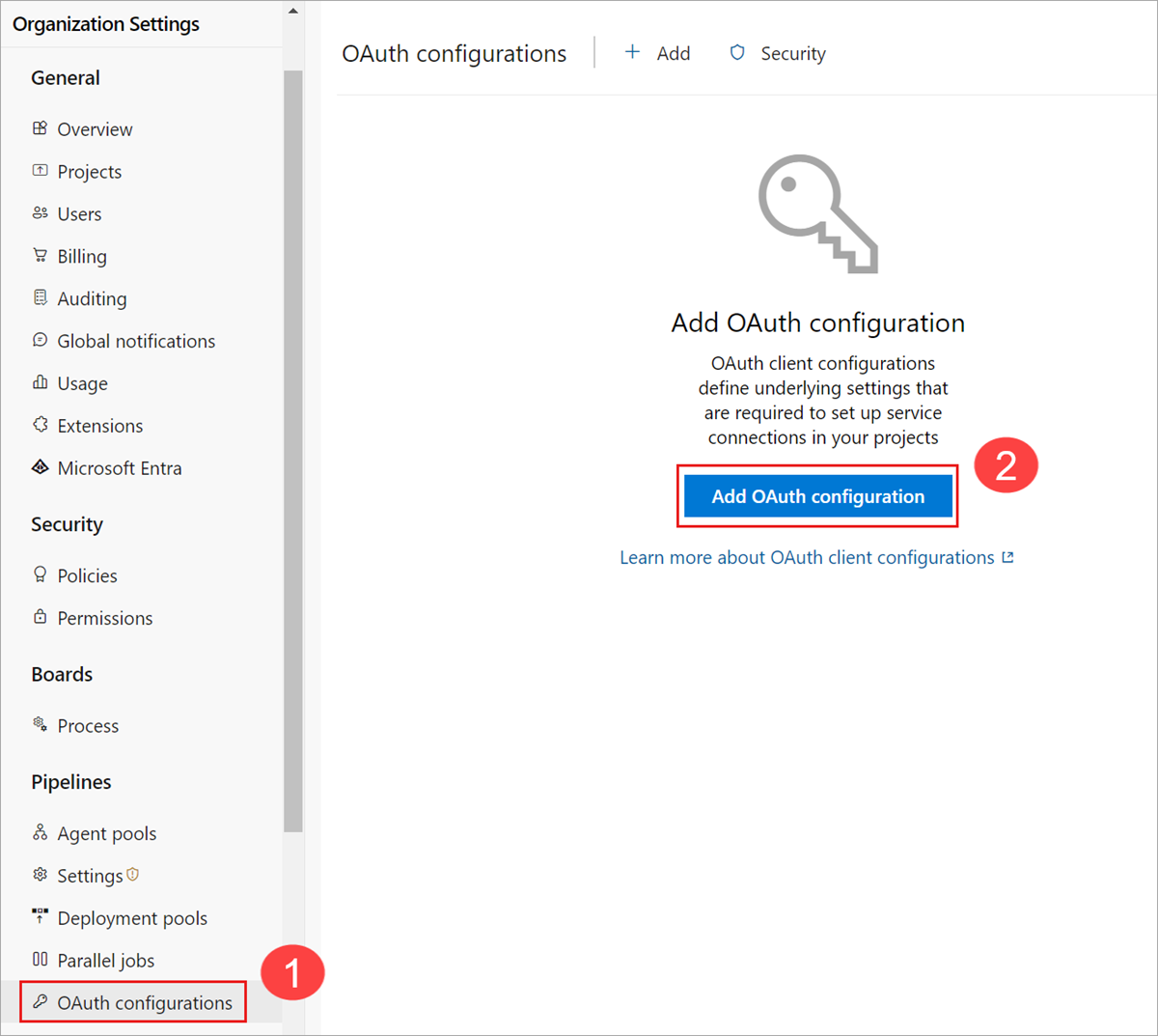

Select Organization settings > Oauth configurations > Add Oauth configuration.
Enter your information and select Create.

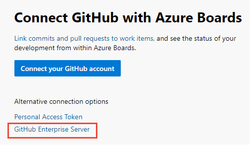

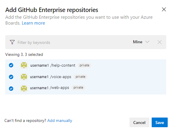

Select Project settings > GitHub connections > GitHub Enterprise Server for a first-time connection.
For subsequent connections, select GitHub Enterprise Server from the New GitHub connection dialog.

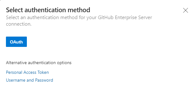

Select the authentication method.

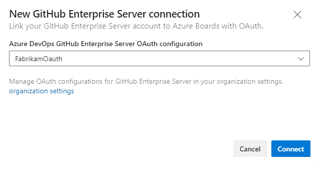

Connect with OAuth — Select the OAuth configuration you registered in Register your OAuth configuration, then select Connect.

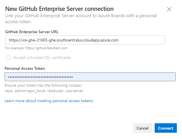

Connect with a Personal Access Token — Enter your GitHub Enterprise Server URL and PAT, then select Connect.

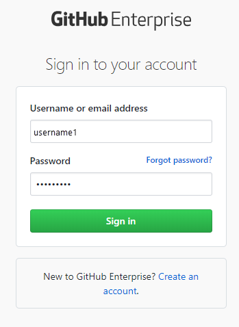

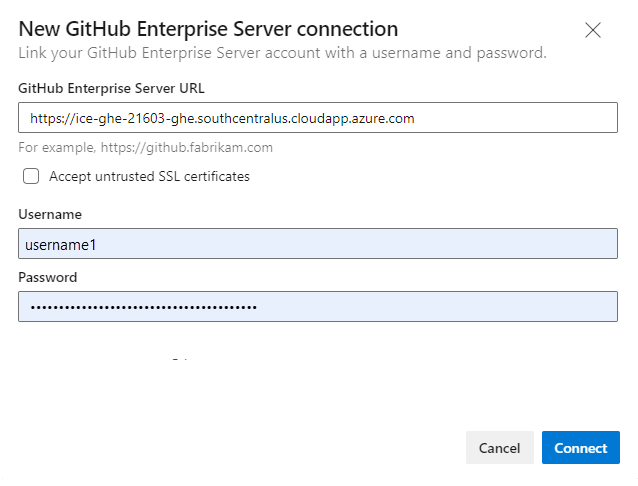

Connect with GitHub credentials — Enter your GitHub Enterprise Server URL and administrator credentials, then select Connect.
The dialog lists all repositories where you have administration rights. Toggle between Mine and All to find additional repositories, select the ones to add, and then select Save.

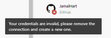

When the Azure Boards connection to GitHub loses access, a red-X alert appears in the UI. Hover over the alert to confirm the credentials are no longer valid. Remove the connection and create a new one.
OAuth connections:
Azure Boards access was denied for one of the repositories.
GitHub or Azure DevOps might be unreachable due to a service outage or network issue. Check status: GitHub | Azure DevOps
Delete and recreate the connection. GitHub prompts you to reauthorize Azure Boards.
PAT connections:
The PAT was revoked or its permission scopes are insufficient.
The user might not have admin permissions on the GitHub repo.
Recreate the PAT with the required scopes:
repo, read:user, user:email, admin:repo_hook. For more information, see Best practices for using PATs.
