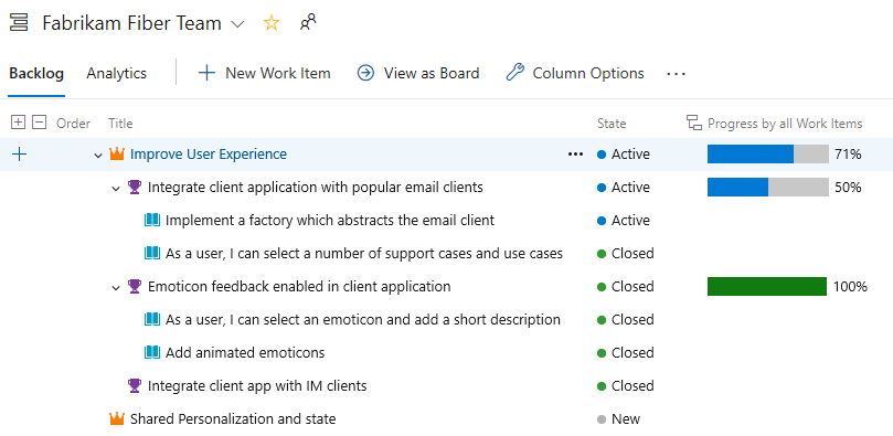

Rollup, hierarchy, and portfolio management
Rollup columns allow you to view progress bars or totals of numeric fields or descendant items within a hierarchy. Descendant items correspond to all child items within the hierarchy. You can add one or more rollup columns to a product or portfolio backlog.
Here we show Progress by all Work Items which displays progress bars for ascendant work items based on the percentage of descendant items that have been closed.
Progress bars showing rollup by work items

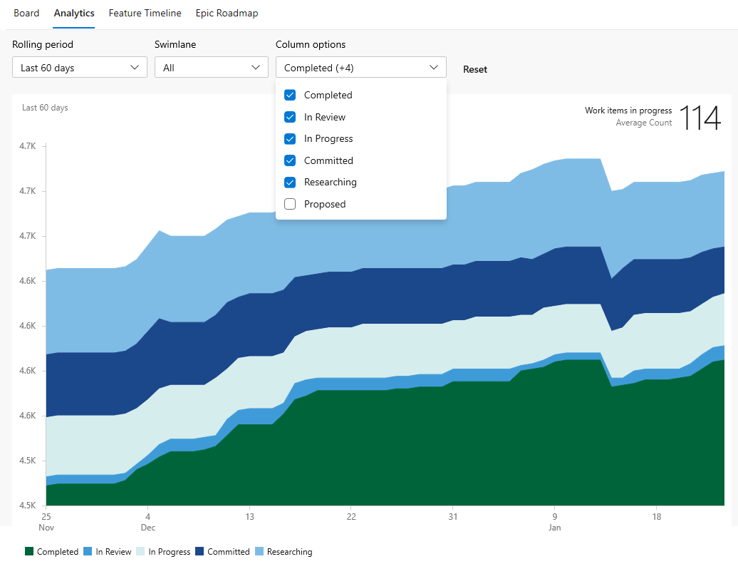

Both workflow states and Kanban columns appear in the Cumulative Flow diagram for a team. Individuals can choose which columns appear in the chart.
Cumulative flow diagram
To learn more, see Cumulative flow diagram.
