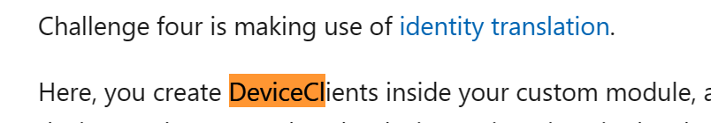

    Challenge four is making use of identity translation.
    Here, you create DeviceClients inside your custom module, acting as proxies for your downstream devices and connected to the device registrations in the cloud. The mapping and exchange of device secrets could be done eg. with desired properties (notice there is a limit to the device twin section size).
