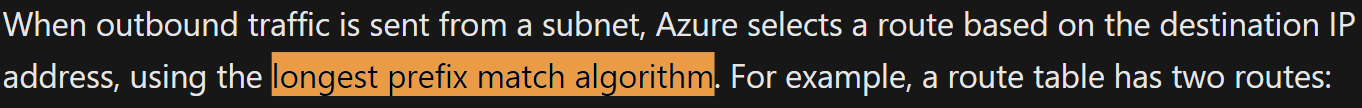

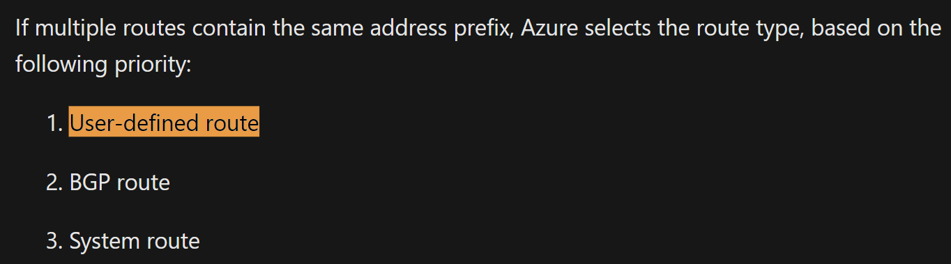

    Wrt, "As far as I understood, a Route table with an entry 0.0.0.0/0 pointing to the Azure Firewall must be setup for each subnet of the spokes in order to force traffic routed to the Azure Firewall."
    • The 0.0.0.0/0 route is used to force Internet Bound traffic or "default" traffic to the Azure Firewall.
    • i.e., if you also want subnet to subnet traffic to go via Azure Firewall, you should define all the subnets in the Route Table and set nextHop as Azure Firewall
      This includes,
      • Spoke1subnet1 <----> Spoke1subnet2
      • Spoke1subnet1 <----> Hub1subnet1
      • Spoke1subnet1 <----> OnPrem
    • The above routes, do not go via Firewall if you only have 0.0.0.0/0 route.
