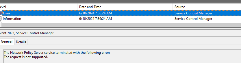

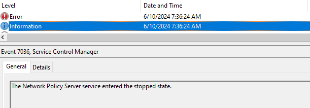

    2. There are only two events on each failure to start: 7036 (The Network Policy Server service entered the stopped state.) and 7023 (The Network Policy Server service terminated with the following error: The request is not supported.) Here are the screen shots of the error itself and the two System event messages: NPS will not start User's image User's image
    3. Before I posted the original question, I had already thoroughly tested the Network Service account to ensure it was correct. This is a new server, and there have been no changeds to this account. All other services running under this account are starting & working correctly. I even tried alternatively running the NPS service under the domain admin, but the same problem persisted.
