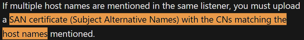

Now, we have received a new requirement: any requests coming from Contoso2.com should also reach the same app service (Contoso.azurewebsites.net). To achieve this, we plan to make the following changes to our existing infrastructure:
  1. DNS Configuration:
    • Map the additional domain name (Contoso2.com) along with existing (Contoso1.com) to the Application Gateway’s public IP address.
  2. Application Gateway Configuration:
    • Modify the listener to listen for requests from both Contoso1.com and Contoso2.com.
    • Set the listener type as Multisite.
    • Set the host type as Multiple/Wildcard.
    • Add both host names (Contoso1.com and Contoso2.com) under the host names section.
  3. App Service Configuration (Contoso.azurewebsites.net):
    • Modify the app service and add one more custom domain to map Contoso2.com along with Contoso1.com
Now, we are seeking guidance on following:
  • Does these modifications are correct?
  • With this, does request from Contoso1.com and Contoso2.com will reach to Contoso.azurewebsites.net?
  • Any more modifications are required or missing?
Your early response is highly appreciated.

    Analysis :
    Is there any specific reason you are doing this instead of redirecting users to the original site?
    • i.e., Give a 3XX response to "contoso2.com"
    • and Redirect users to "contoso1.com"
    The challenges I am seeing with your set up are
    #1
    You are using App Service Entra authentication.
    • I believe the call back URL is configured with "contoso1.com"
    • So when users are accessing the "contoso2.com", and during authentication, there is a possibility that they get redirected to "contoso1.com" from Entra
    #2
    Instead,
    • I would suggest you consider redirecting users to the original site "contoso1.com".
    • And redirect users from "contoso2.com" to "contoso1.com"
    Without Authentication, your action plan should work.
    Kindly let us know if this helps or you need further assistance on this issue.
