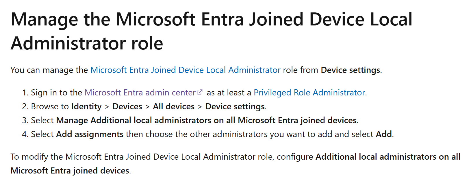

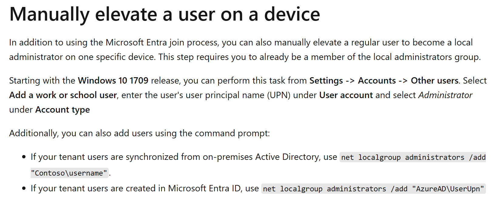

    You can add local administrator accounts from Entra ID to Entra ID joined devices following the steps from this document:
    https://learn.microsoft.com/en-us/entra/identity/devices/assign-local-admin
    By doing so, you wouldn't need to have your users sharing their passwords with the admins since the selected admins would have full access to the device instead.
