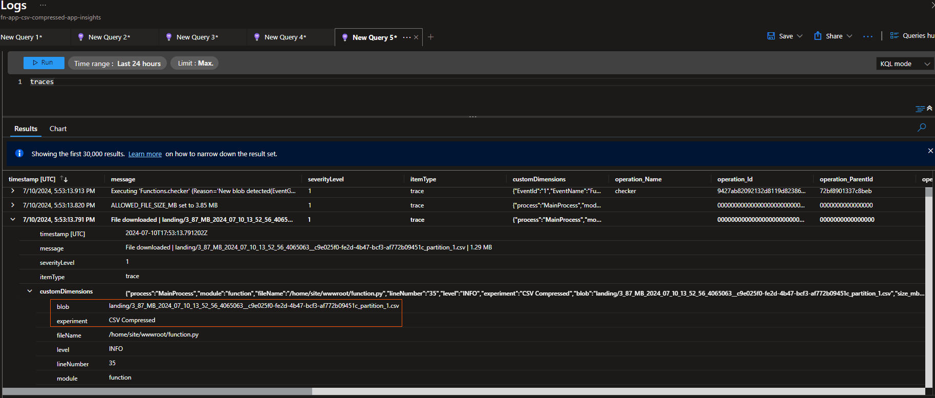

I have a function blob trigger based with event grid as source. I'm trying to send costom data (customDimension) to Log Analytics via App Insights
This is an example code setup
from services.blob_service import BlobService
from services.queue_service import QueueService
from opencensus.ext.azure.log_exporter import AzureLogHandler
EXPERIMENT_NAME = 'CSV Compressed'
logger = logging.getLogger(__name__)
logger.addHandler(AzureLogHandler())
def checker_fn(blob:func.InputStream, context:func.Context):
    blob_content = blob.read()
    size_mb = round(len(blob_content) / (1024 * 1024), 2)
    logger.info(f'File downloaded | {blob.name} | {size_mb:,} MB', extra={
        'custom_dimensions' : {
            'experiment' : EXPERIMENT_NAME,
            'blob' : blob.name,
            'size_mb' : size_mb,

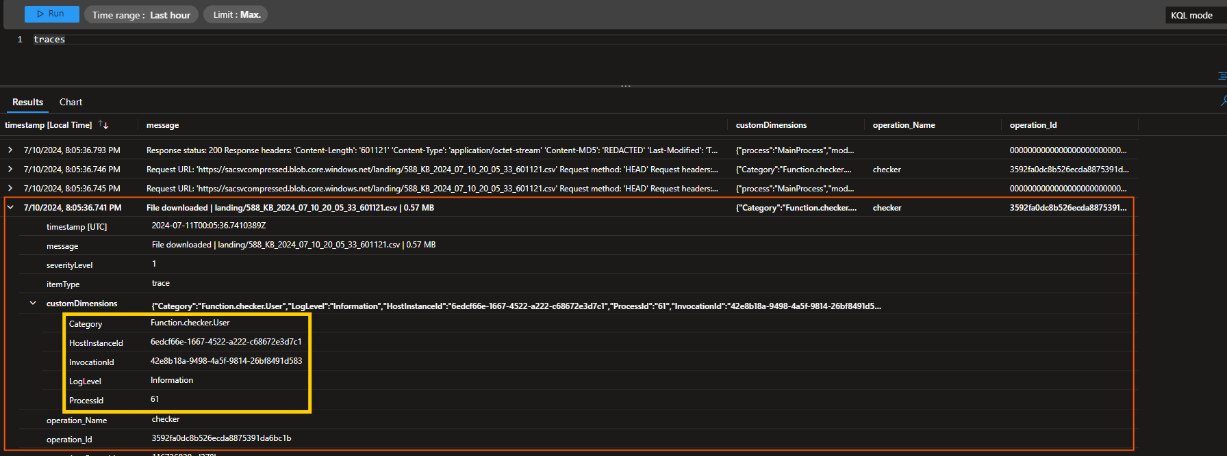

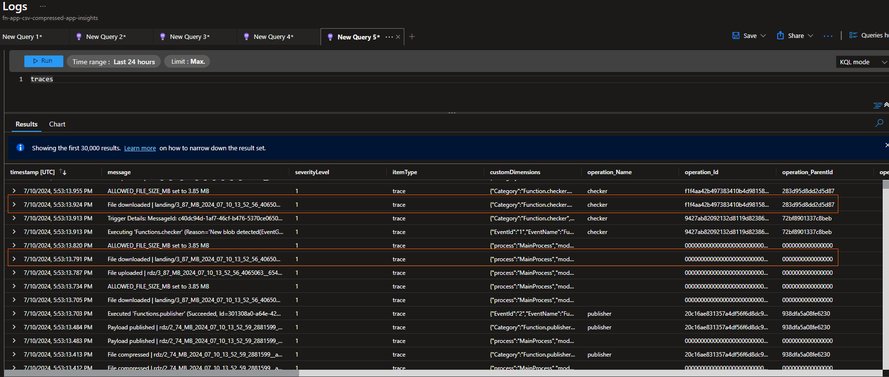

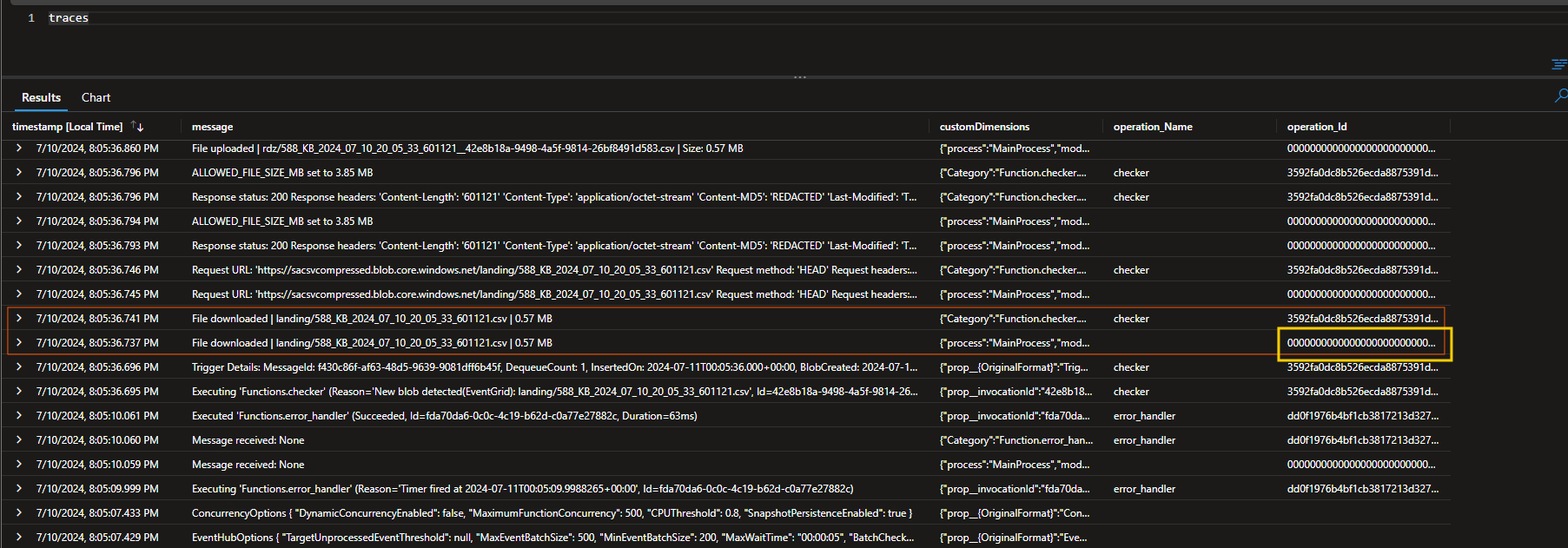

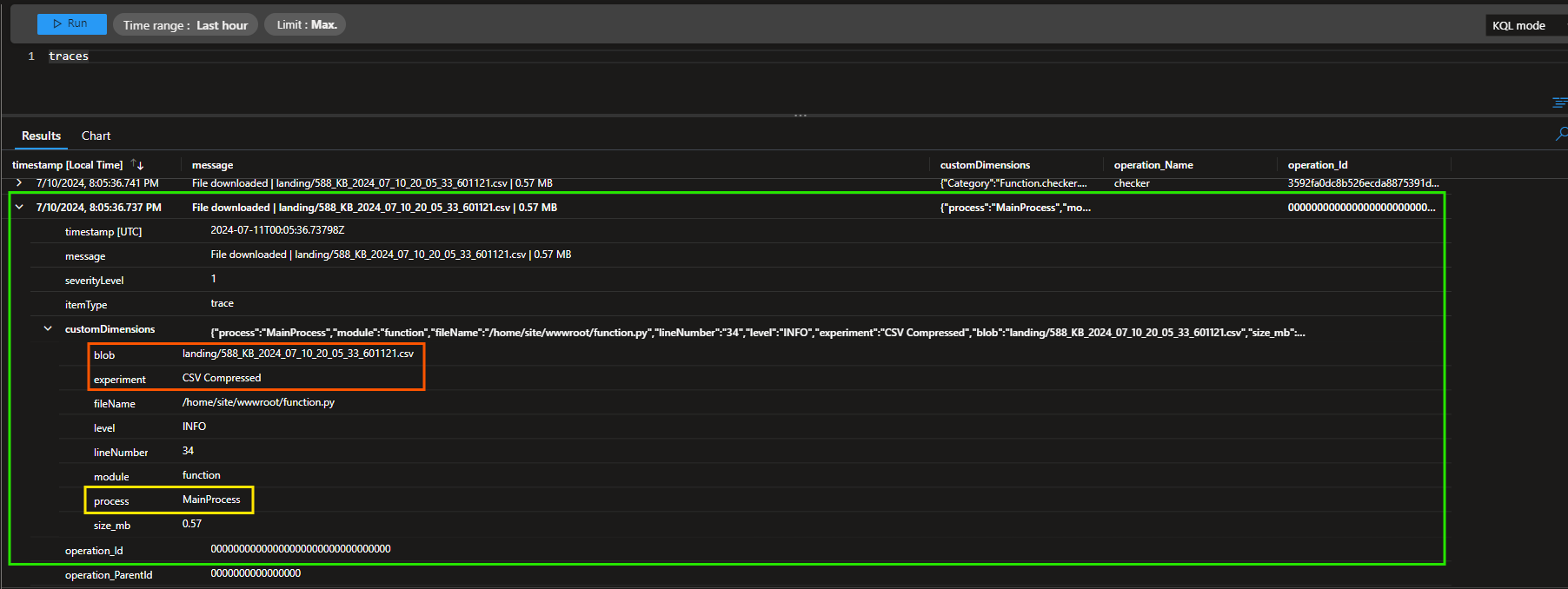

However, while watching the logs, I see two entries of the same log message; one with the custom dimension and the other that hasn´t it.
log1
The entry that doesn't have operation_Name contains my custom data in the customDimension column. I'm following this example and this doc.
I know OpenCensus is deprecated, but this is legacy code that need to work as it is for now.
Why is this?
