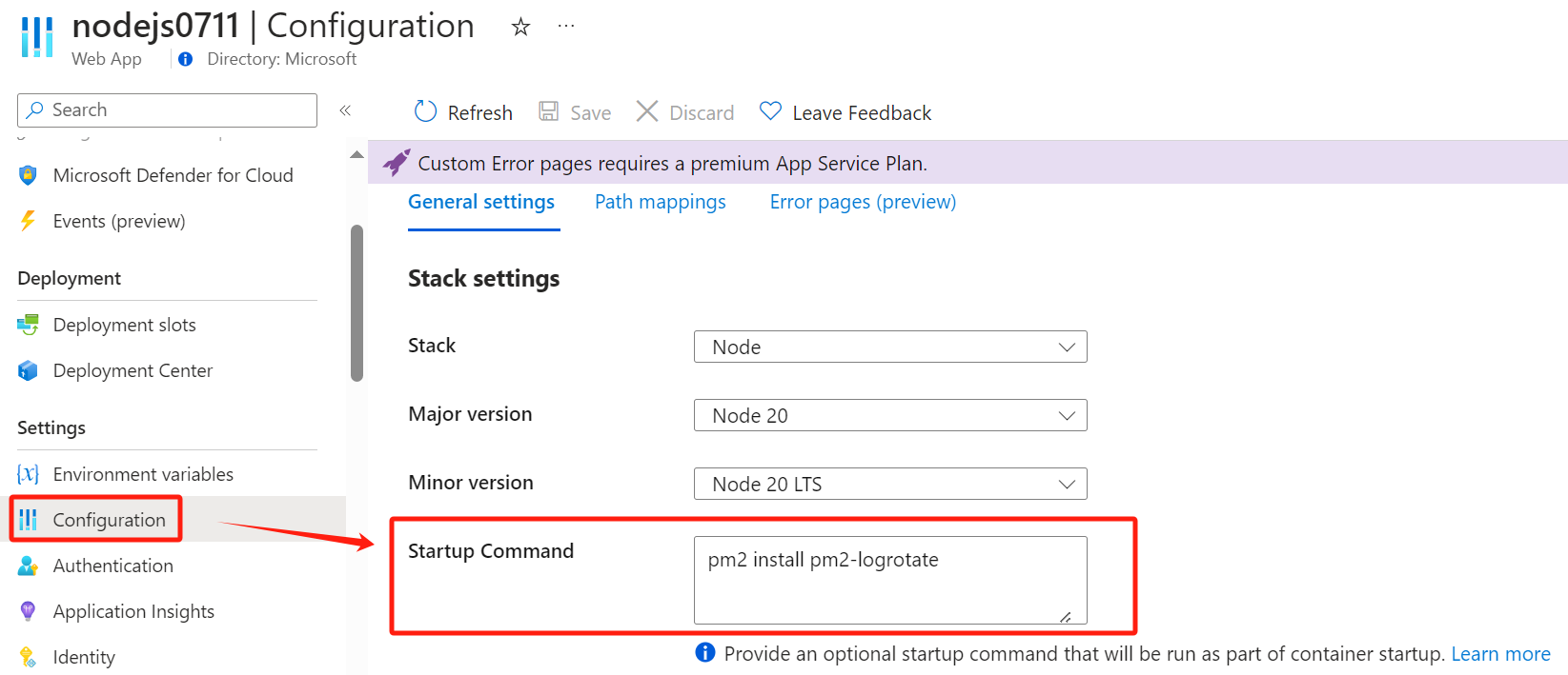

We need to install pm2-logrotate module in webapp, however the webapp can't start when input startup command in App Service. Could you please help to confirm how to write the start command in nodejs webapp and let the webapp start successfully?

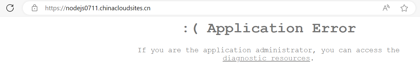

Error screenshot : If we don't input start command in webapp, the webapp can start successfully.User's image
Start command: install pm2-logrotate moduleUser's image

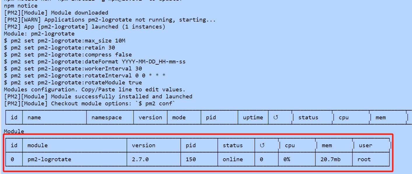

Default docker log: we can see the pm2-logrotate module was installed successfully.

2024-07-11T15:25:53.035646011Z [PM2][Module] Module downloaded
2024-07-11T15:25:53.080548800Z [PM2][WARN] Applications pm2-logrotate not running, starting...
2024-07-11T15:25:53.188017714Z [PM2] App [pm2-logrotate] launched (1 instances)
2024-07-11T15:25:53.197364433Z Module: pm2-logrotate
2024-07-11T15:25:53.197985334Z $ pm2 set pm2-logrotate:max_size 10M
2024-07-11T15:25:53.199967838Z $ pm2 set pm2-logrotate:retain 30
2024-07-11T15:25:53.206671551Z $ pm2 set pm2-logrotate:compress false
2024-07-11T15:25:53.208114954Z $ pm2 set pm2-logrotate:dateFormat YYYY-MM-DD_HH-mm-ss
2024-07-11T15:25:53.208132554Z $ pm2 set pm2-logrotate:workerInterval 30
2024-07-11T15:25:53.208453355Z **$ pm2 set pm2-logrotate:rotateInterval 0 0 * * ***
2024-07-11T15:25:53.209702557Z $ pm2 set pm2-logrotate:rotateModule true
2024-07-11T15:25:53.209722157Z Modules configuration. Copy/Paste line to edit values.
2024-07-11T15:25:53.217413973Z [PM2][Module] Module successfully installed and launched
2024-07-11T15:25:53.226902092Z [PM2][Module] Checkout module options: $ pm2 conf
2024-07-11T15:25:53.403106642Z ┌────┬──────────────────┬─────────────┬─────────┬─────────┬──────────┬────────┬──────┬───────────┬──────────┬──────────┬──────────┬──────────┐
2024-07-11T15:25:53.403164742Z │ id │ name │ namespace │ version │ mode │ pid │ uptime │ ↺ │ status │ cpu │ mem │ user │ watching │
2024-07-11T15:25:53.403173142Z └────┴──────────────────┴─────────────┴─────────┴─────────┴──────────┴────────┴──────┴───────────┴──────────┴──────────┴──────────┴──────────┘
2024-07-11T15:25:53.406698349Z Module
2024-07-11T15:25:53.433406102Z ┌────┬──────────────────────────────┬───────────────┬──────────┬──────────┬──────┬──────────┬──────────┬──────────┐
2024-07-11T15:25:53.433458903Z │ id │ module │ version │ pid │ status │ ↺ │ cpu │ mem │ user │
2024-07-11T15:25:53.433466003Z ├────┼──────────────────────────────┼───────────────┼──────────┼──────────┼──────┼──────────┼──────────┼──────────┤
2024-07-11T15:25:53.433470903Z │ 0 │ pm2-logrotate │ 2.7.0 │ 150 │ online │ 0 │ 0% │ 20.7mb │ root │
2024-07-11T15:25:53.433475703Z └────┴──────────────────────────────┴───────────────┴──────────┴──────────┴──────┴──────────┴──────────┴──────────┘
