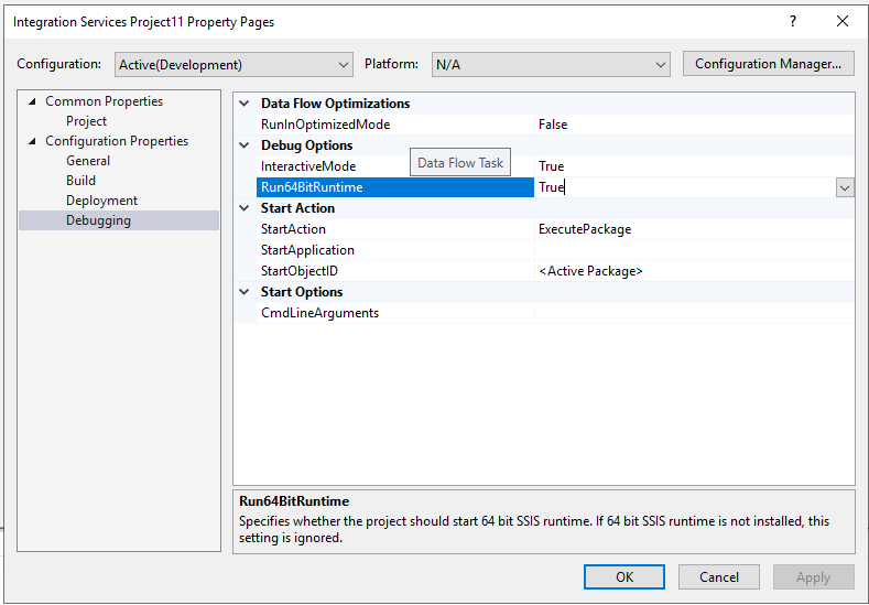

    3. Configuration Properties -> Debugging -> Change Run64BitRuntime value from True to False:
    However when I config my Connection Manager to connect to my excel sheet and data access mode=SQL command and hit preview I get the same error as below...
