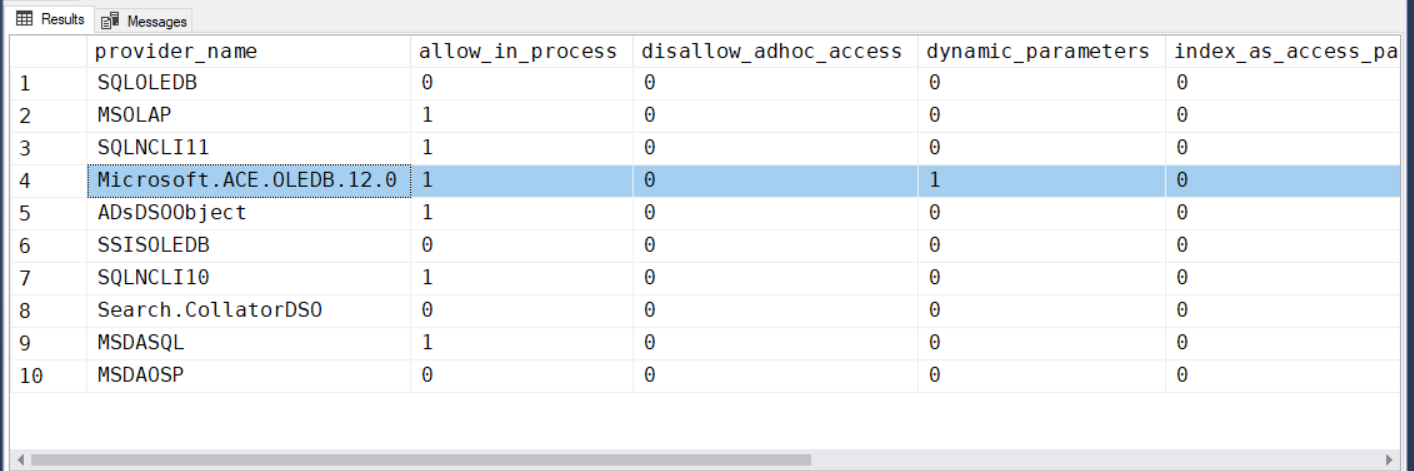

    To check if 64-bit ACE OLEDB provider is installed on the server, run the following statement in SSMS:
    EXEC master.sys.sp_MSset_oledb_prop;
    It should look along the following screen shot, though the ACE version could be different:

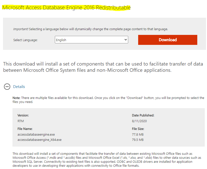

  4. Monalv-MSFT 5,926 Reputation points
    2020-12-02T07:16:20.56+00:00
    Hi @Anonymous ,
    Please download Microsoft Access Database Engine.
    Hope the following links will be helpful:
    1.Microsoft Access Database Engine 2016 Redistributable
    2.Installing the Microsoft.ACE.OLEDB.12.0 Provider for Both 64-bit and 32-bit Processing
    Best Regards,
    Mona
