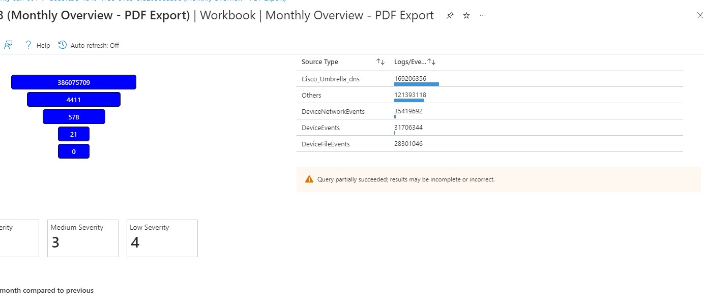

Hi all,
i having this issue on a workbook, when i try to run the report, the workbook report throw an error message Query partially succeeded; results may be incomplete or incorrect. i have attach the screenshot. workbooks error message.jpg

  1. Clive Watson 7,866 Reputation points MVP Volunteer Moderator
    2024-08-06T14:34:54.08+00:00
    This may help, however the query you shared doesnt look like the one in the Workbook error? Anyway taking the query provided, I use Materialize() to cache the data - so its only runs once rather than the 4 times with your let statements.
    I only did a few basic tests, but it runs in roughly half the time, I'm not sure it will help, but worth a try against your data set.
    2024-08-06T06:59:55.8033333+00:00
    This can often be down to one of three or four reasons: https://learn.microsoft.com/en-us/azure/data-explorer/kusto/concepts/partial-query-failures
    Try to limit or filter the data the query processes. Do you get a different results outside of a Workbook, in the Logs blade?
    It looks like you are counting events in many tables over a month, that could be a lot of data process. If you share the query maybe we can help optimise it?
