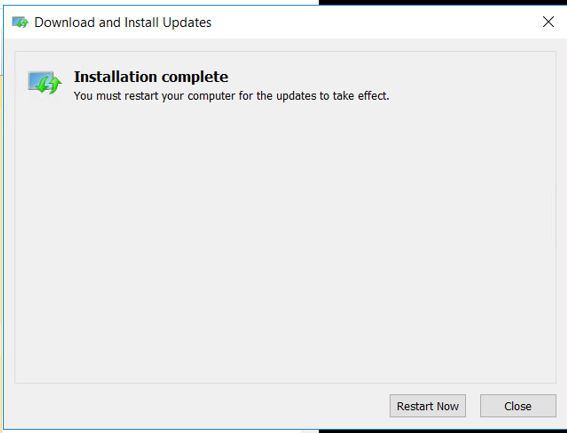

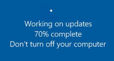

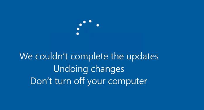

Hello Team,
When I install the KB5040434 either through WSUS or manually, it is getting installed, rebooting after that the below screen appears
pic2
pic3
pic4
It is getting rolled back only in this Domain controller, the similar domain controller server 2016 in the same site is having no problem

    2024-09-15 08:13:11, Error                 CBS    Startup: A possible hang was detected on the last boot. [HRESULT = 0x800f0920 - CBS_E_HANG_DETECTED] ,
    2024-09-15 08:13:11, Error                 CBS    Startup: No progress detected while needing to process the advanced operation queue, rolling back and cancelling the transaction. [HRESULT = 0x80004005 - E_FAIL]
