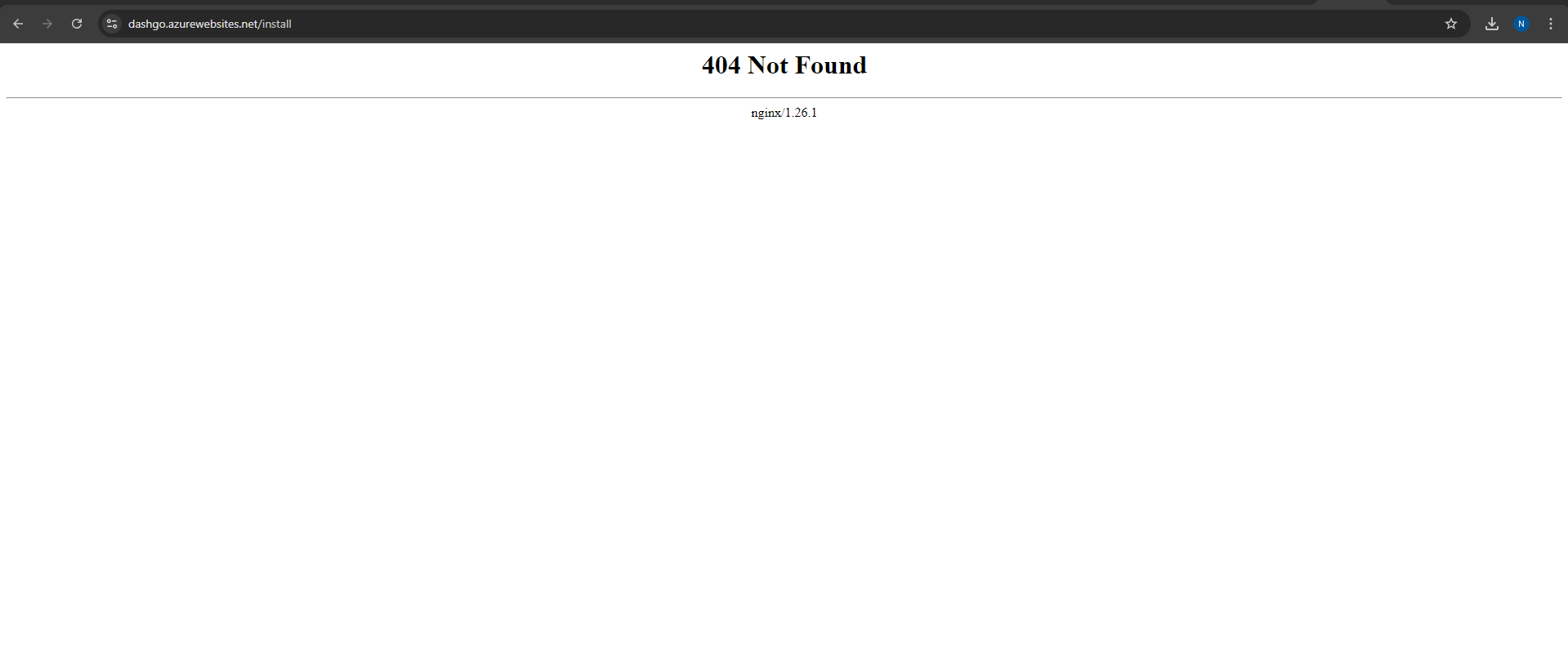

How to fix nginx 404 error while accessing the site . I already tried the given solution in the document.

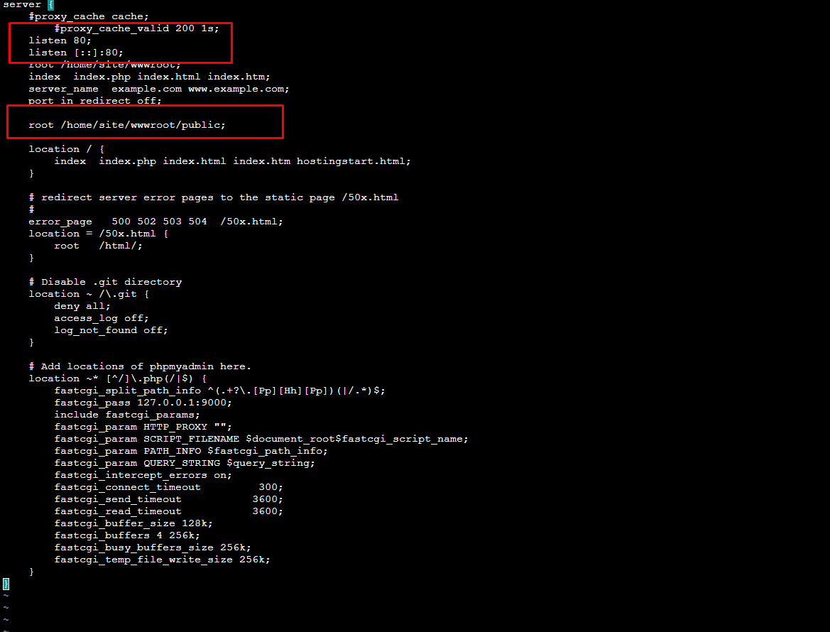

I just changed the below data in for nginx configUser's image
image_2024_09_20T12_22_03_795Z
image_2024_09_20T04_07_19_812Z

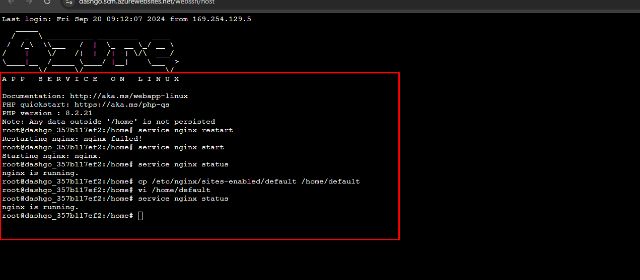

cp /etc/nginx/sites-enabled/default /home/default
vi /home/default
cp /home/default /etc/nginx/sites-enabled/default; service nginx start

    Durgesh Pandey , Apologies for the delayed response. Based on my understanding of your issue description, I see that you have already tried multiple things to isolate the issue, just to highlight some common causes of 404 errors, such as incorrect URL paths, misconfigured NGINX settings, and issues with PHP file handling. What app framework are you leveraging? -NGINX may show a 404 while application logging indicates a HTTP 5xx was actually returned.
    Ultimately, this is due to the fact that the error_page directive in NGINX’s default.conf returns a non existent /50x.html when HTTP 5xx’s are returned. Please check this - PHP configuration: Customizing NGINX’s error page handling
    -Please confirm if npm run build or yarn run build is expected to be ran - or if the production build folder is set in a .gitignore.
    • For example, using Oryx as a deployment method - a custom deployment script may be needed - see Oryx - Configuration and POST_BUILD_COMMAND or POST_BUILD_SCRIPT_PATH
    I see that you have highlighted config details in the screenshot, juts to confirm - A common theme is with frameworks again - such as Laravel and Yii - where the application is served out of /public/ or /web/ - which would equate to /home/site/wwwwroot/public or /home/site/wwwroot/web - whereas NGINX’s default root is /home/site/wwwroot.
    Kindly enable App Service Logging and then review application logs to fetch more info.
