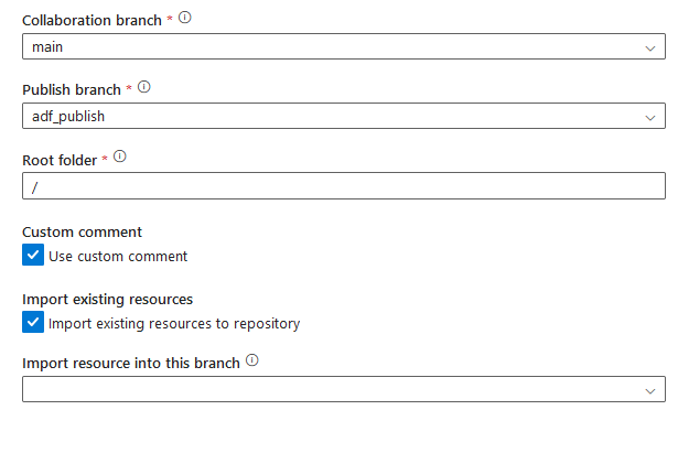

I've modified my datafactory through python SDK and added some trigger. Now my publish branch is out of sync with the main branch. I found the theoretical solution here: https://learn.microsoft.com/en-us/azure/data-factory/source-control#connect-to-a-git-repository
grafik But my target is a fully automated workflow. I can indeed also delete the git repository from python (which works). But while adding the same configuration as before i have no option to override the branch (as i would have while using the GUI). The "Import resource into this branch" is not accessible from python SDK as far as i've understood.
grafik
How can i achieve an automated creation of trigger via python SDK without having to manually update my main branch?

    Another approach is to manually set up the initial configuration in the GUI as per your screenshot (with "Import existing resources to repository" checked). Afterward, make only minor updates via the Python SDK, which should reflect in both the publish and collaboration branches without needing a full re-import.

    What I need is a way to push the current Data Factory configuration into a Git branch using the Data Factory REST API or Python SDK. However, I couldn't find an option for this. Even after removing and re-adding the Git configuration, the active configuration of the Data Factory is not automatically pushed to the selected branches.
    If this were done manually, there is an "Import from Branch" option, but as far as I can tell, this functionality is not accessible via the Data Factory REST API or Python SDK.
