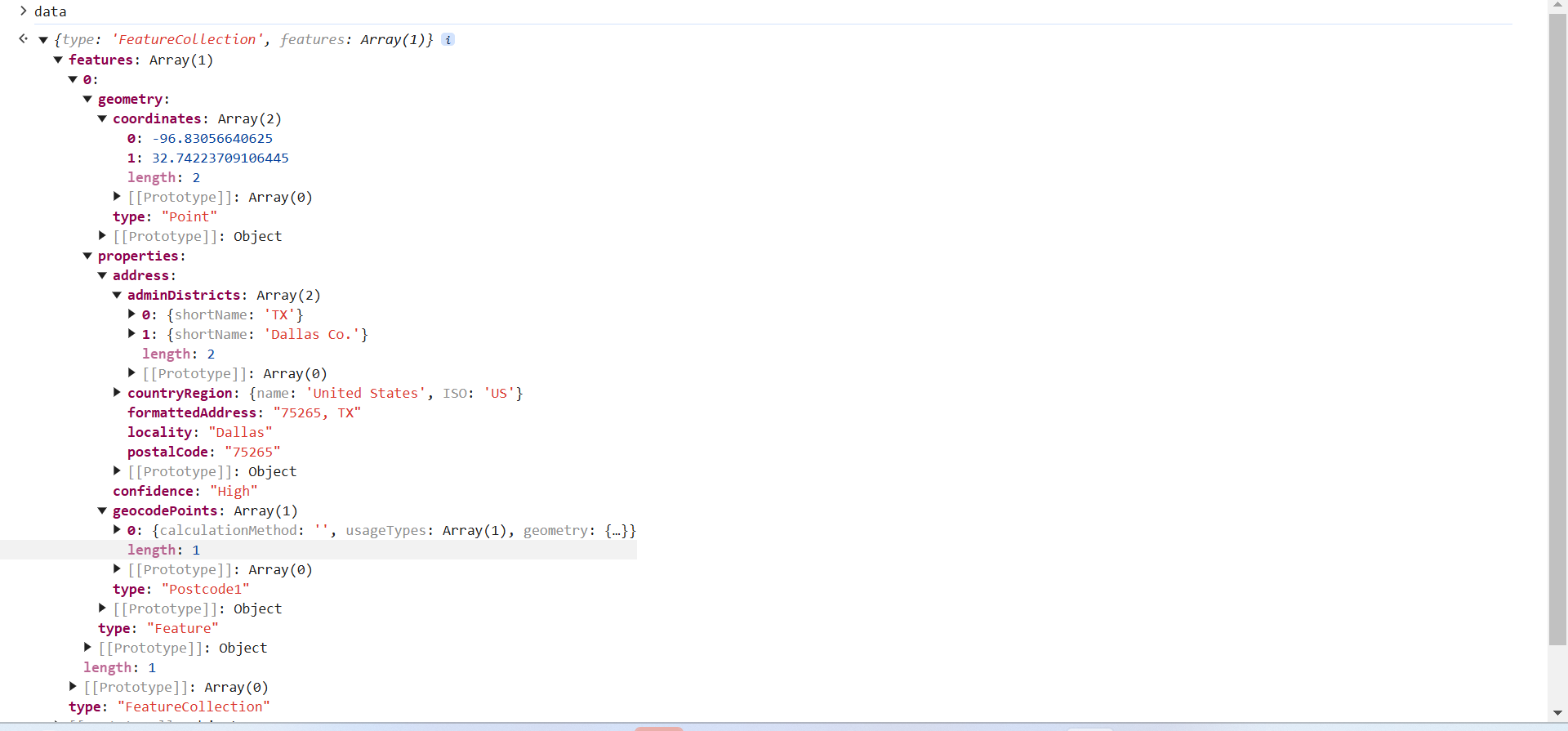

For example, when I call the geocode API for postal code 75365, which is in Dallas, Texas
https://atlas.microsoft.com/geocode?api-version=2023-06-01&view=Auto&top=1&countryRegion=&postalCode=75265&adminDistrict=&locality=&adminDistrict2=&subscription-key=
I get the following response. Screenshot (97)

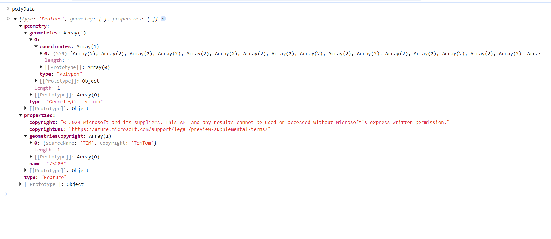

And when I request the Get Search Polygon API
https://atlas.microsoft.com/search/polygon?api-version=2023-06-01&coordinates=-96.83056640625,32.74223709106445&view=Auto&resultType=postalCode&resolution=medium&subscription-key=
Screenshot (96)
as you can see here, the postal code I get from the response is 75208, which is different. I searched for the postal code 75265, so my understanding is that I should have received the postal code 75208. Am I doing it in an incorrect way or did i miss something between the steps, but the boundaries I am getting are the correct ones.

    First off, it's important to note that the geocoder and the boundary services are independent of each other. The v2 boundary service will retrieve any boundary that intersects with the coordinate provided. This is good for hierarchy type searches, but can be error prone if a "display coordinate" (center point) is used for an area that has an irregular shape and thus the display coordinate does not overlap the boundary. Normally I would recommend using the V1 services when searching for a specific boundary since each boundary in that version has a unique ID that is returned by the geocoder. However, if you go down that path you will find none of the zip codes you provided will return a boundary ID, which indicates that it's not a data issue. Digging into this I found that these zip codes are "non deliverable zip codes" like PO boxes which have no area (multiple zip codes can exist in the same spot). Around 30% of US zip codes are like this. For example, the building that has a PO box will have a street address and zip code that aligns with the wider area it is in, while it may contain one or more zip codes for its boxes. These zip codes are points, and have no area. In the case of 75265, it is within the zip code area of 75208. I used this tool to verify: https://www.unitedstateszipcodes.org/ You can also us some tools on the USPS site, but they are less intuitive. Good similar discussion on this can be found here: https://gis.stackexchange.com/questions/22324/where-can-i-find-a-list-of-non-deliverable-zip-codes
