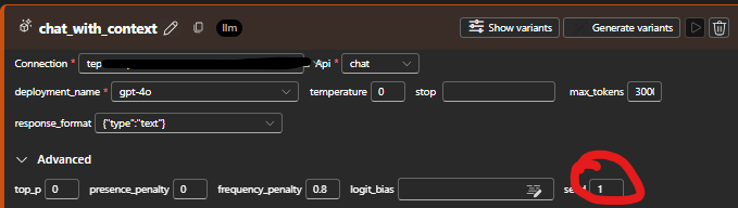

I am using azure virtual machines to host a LLM that is in a RAG model. I ask it the same question multiple times and it gives me different results. It says 'I don't know the answer' sometimes and sometimes it gives the actual answer (which is the correct answer). In the prompt, I specified for the model to say 'I don't know the answer' when the answer is not in the context. Why would it miss categorize the response in different iterations?
A note is that I have temperature = 0, top_p = 0, and a random seed set on the model. It seems that the Azure AI Search is giving the same result each time the question is asked (the model uses the context from the search).
