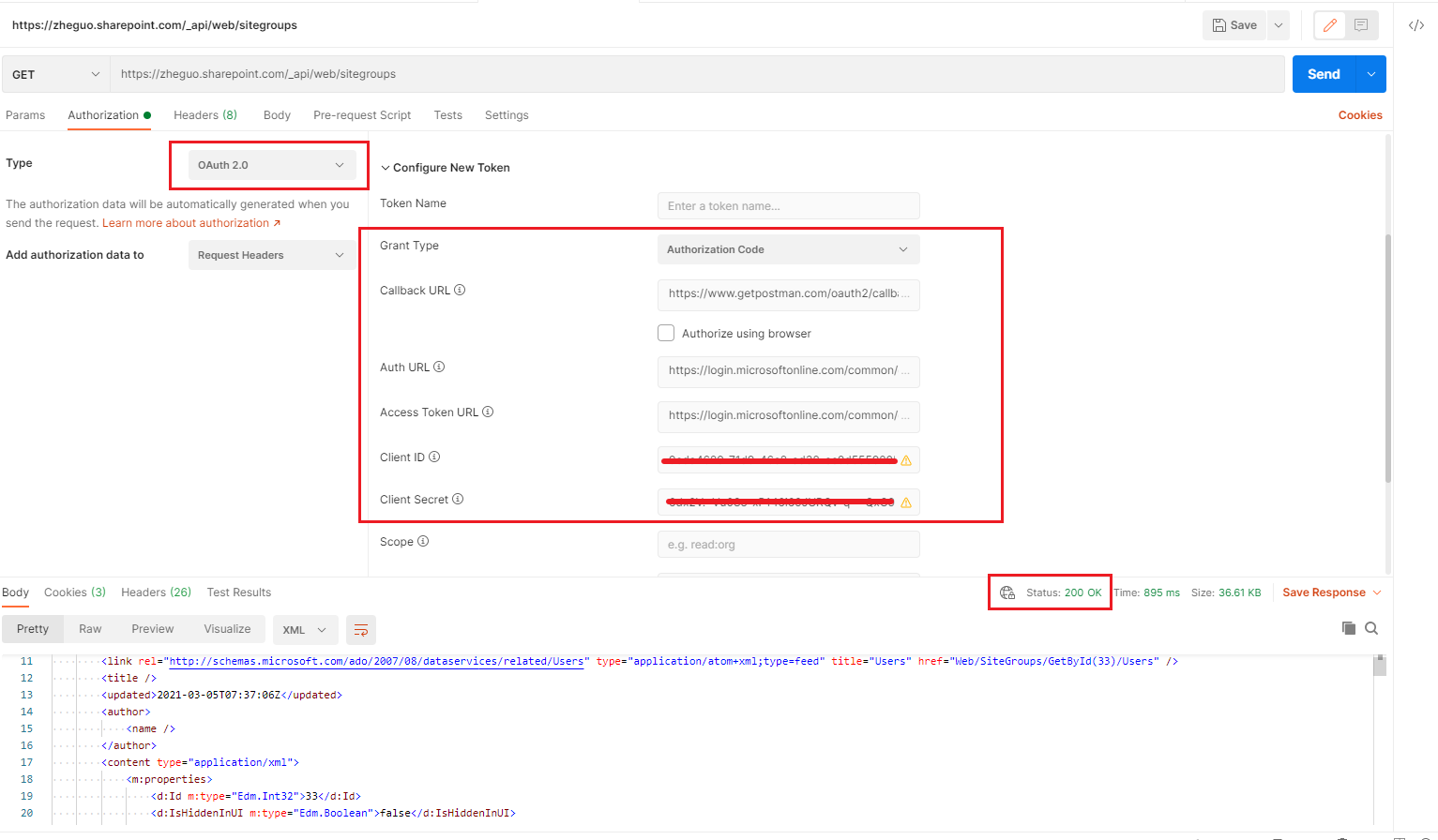

    I would recommend you to get the acccess token in PostMan by Azure AD for a testing purpose.
    Callback URL:        https://www.getpostman.com/oauth2/callback
    Auth URL :           https://login.microsoftonline.com/common/oauth2/authorize?resource=https://<tenant_name>.sharepoint.com
    Access Token URL :   https://login.microsoftonline.com/common/oauth2/token
    Client ID :          <Application_ID>
    Client Secret :      <KEY>
    Grant Type :         Authorization Code
    Will pop up a login window to sign in and then generate the access token and get the SharePoint groups:
    enter image description here
